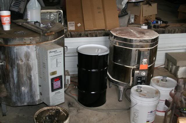

Here's the kiln:
It's the one on the right. The one on the left is a 3 phase model with a digital controller that I've had for a while and use for tempering long blades and things that need to be tempered at a higher degree than a toaster oven reaches.

I work at the factory that made the kiln on the left. It is nice to see one of our kilns in use.
The kiln you are working on has a Dawson Kiln Sitter. After you add the digital controller, the Kiln Sitter might make a handy backup shutoff device.

Arnold - I've appreciated having the Paragon around. It came out of a local high school and is 3 phase, so I picked it up relatively cheaply on Craigslist, and have used it quite a bit, though I don't really challenge its capabilities.
On this new one, I got my thermocouple installed, set the parameters on the PID, ran the Autotune function, set the temperature, and can't figure out how to get the blasted thing to start heating. I've looked through the manual (it'd be great if they got someone who actually speaks English to do the translation), scoured Youtube, and cannot find how you get the darn thing to actually start heating. It's displaying the temperature that I want it to be and the actual temperature, but it's not heating. Anyone have step-by-step instructions for a dummy in getting this thing to turn on?
I am not sure about that PID and how it functions, but the ones I use have no off/on type function. Once I set it it starts working unless I place the one that is programmable on hold. I would check to the SSR to see if it is getting turned on. If it is then check the connections to the elements if not, check the wiring from PID to SSR. Do you have a door switch and is it getting closed?
No door switch. The SSR did get dropped during the re-wiring, so when I ordered the thermocouple I got a backup SSR too. Maybe I should swap 'em out and see if that does the trick.
