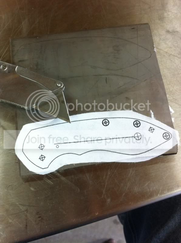

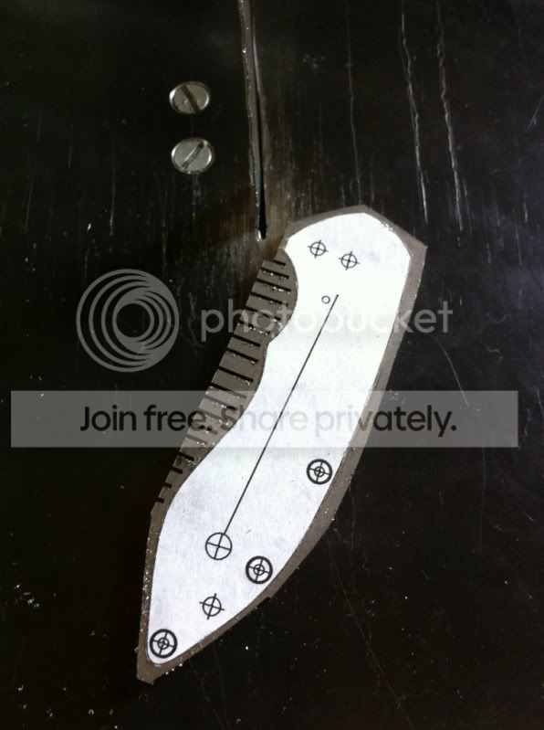

Just wanted to show what I've been doing.

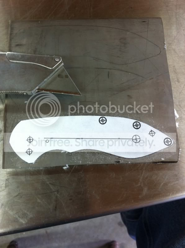

This is how I scribe out the design to cut it out. I cut it out a little oversize. Then i use spray glue to stick it to the titanium. then i cut along the lines with a razor knife. And punch all my holes.

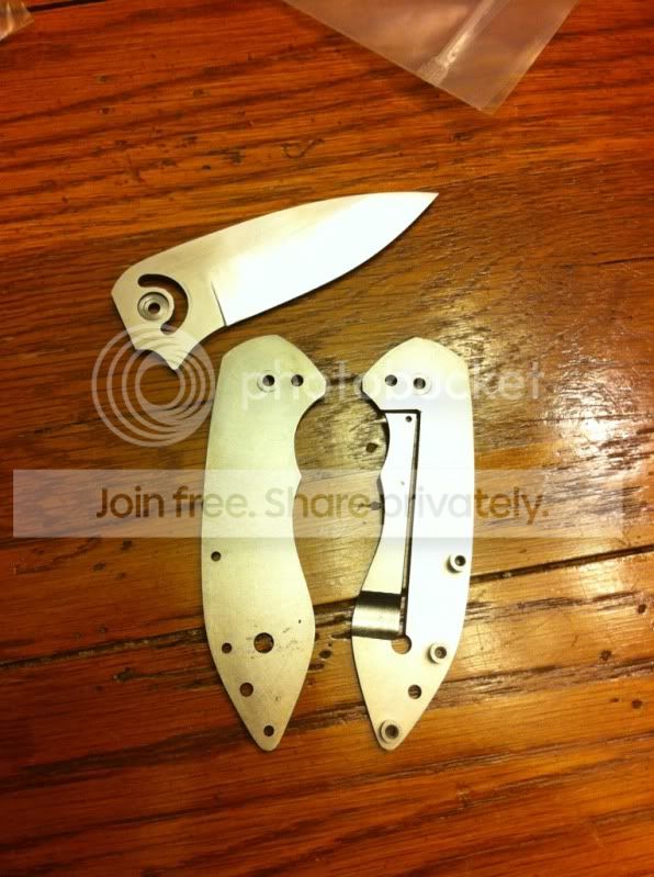

This is where I'm at now. Little slow now while I build my new shop.

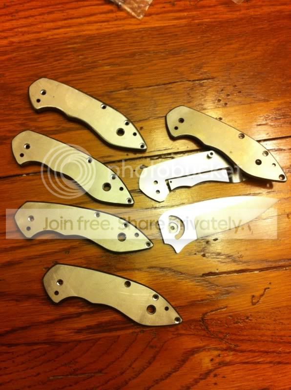

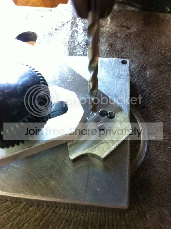

There are 5 knives in this picture. The frames are still glued together on the left. I glue them together to drill and ream the holes and grind to shape.

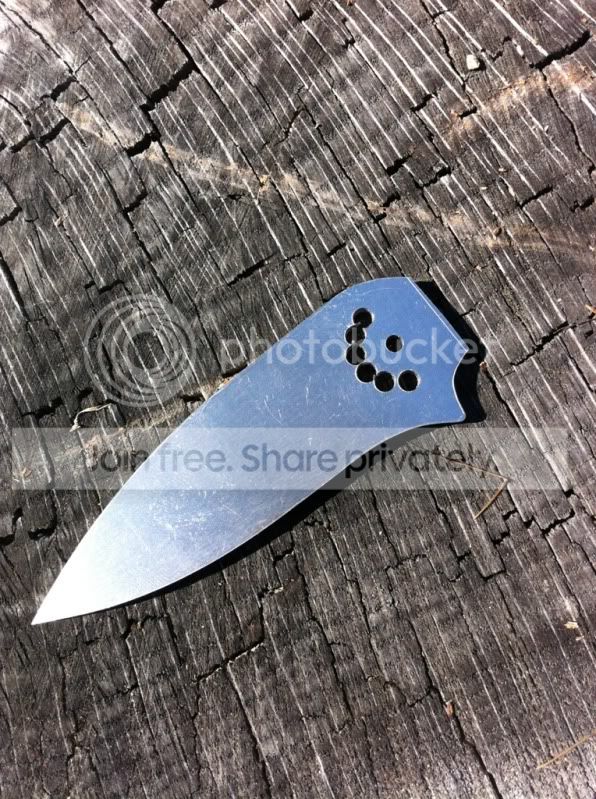

Had to take a little break from knifemaking. But here is few pictures of one just about finished.
That is a nice looking knife. I really like the fact that the blade does not have the "obligatory" jimped thumb ramp.

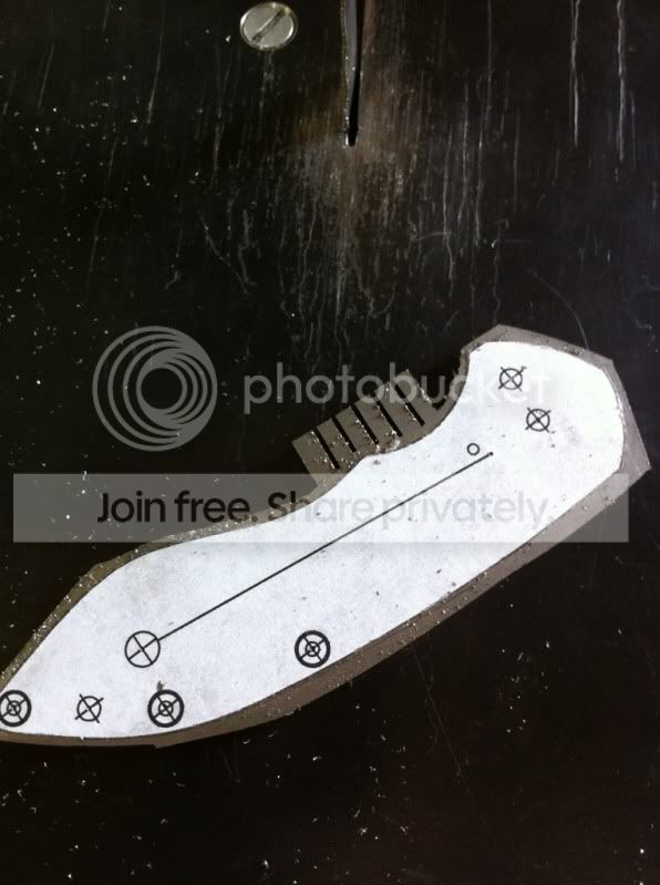

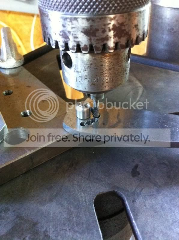

Here's how I cut the lock. And the relief cut. Thats a 1/4" carbide cutter found at Ace.
Awesome I always wondered how to cut out the lock bar. Lookin good, I wanna try a frame lock:cool:
Also wondering how you lined up those holes for the stop pin to travel in?
Are you using a mill or is that an end mill chucked up in your press? I love the carbide cutter method!
Great looking knives.
It's a drillpress. I set it to its fastest setting. Works great.
