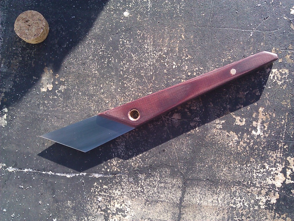

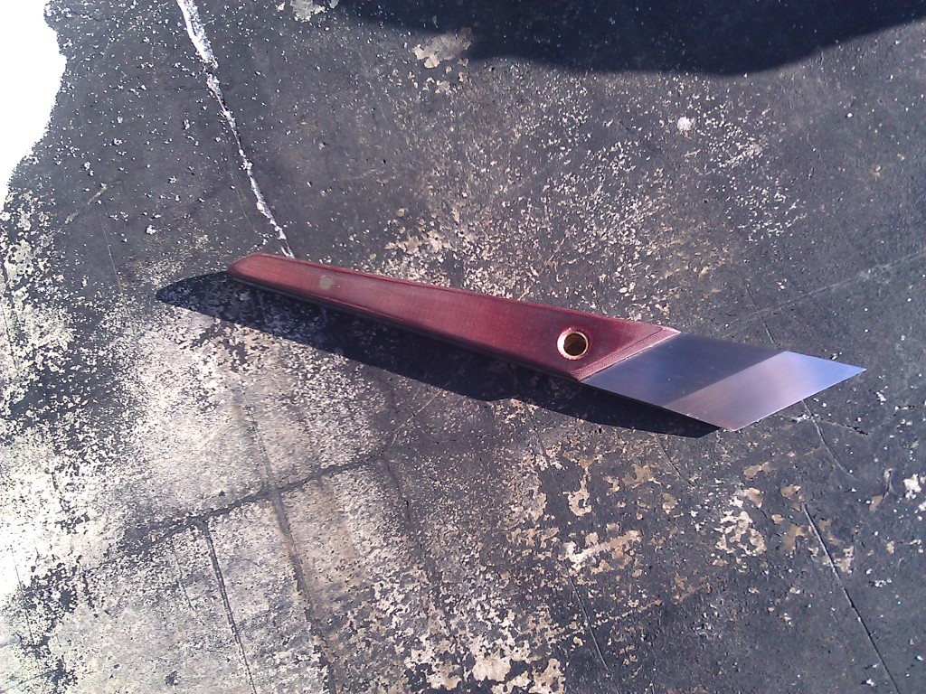

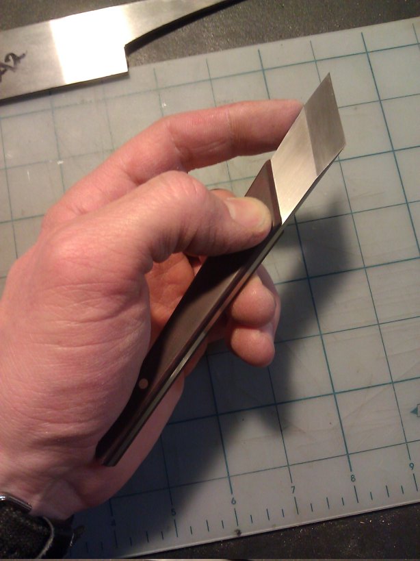

I think this was a leftover from another 'dashi.
It's 1/8" A2, single-side ground and sharpened on the back. Scales are gently beveled 1/8" linen micarta at 360grit. This is something of a quick-finish work knife, completed with only a modest amount of hand sanding.
