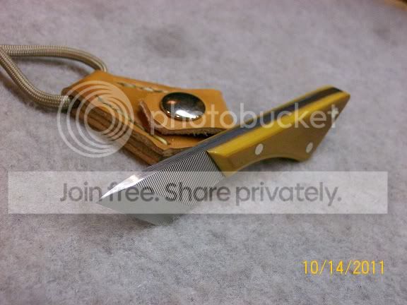

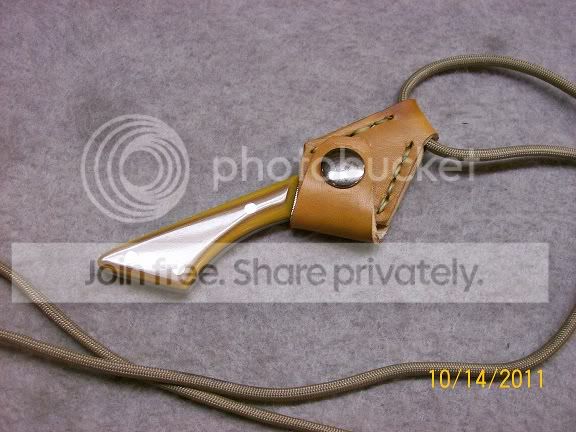

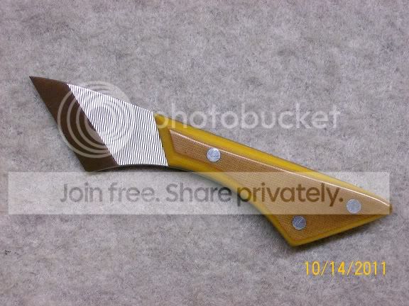

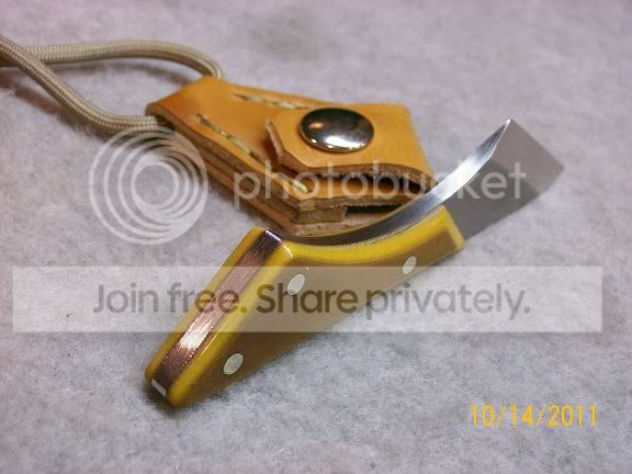

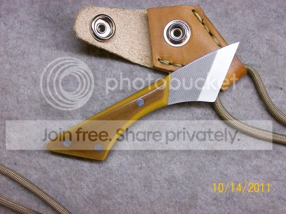

Someone asked me if I ever made a 'Kiridashi' style... Here's my first attempt. I've never seen quite this design before (I did a google search and you'd be suprised how many come up)... The idea was for it to have a profile that looks the same from both ends (I can't think of the right word for that)... Not what you'd grab if the zombies attack, but a perfect little cutter for the right job at the right time... Your thoughts?
That's cool! (I like the sheath too.) :thumbup::thumbup:

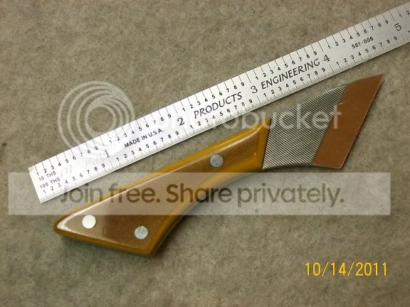

Sorry, forgot the details... About 4.5" long, 1 5/16" edge, made froom a Nicholson file tempered to 56-58Rc., natural micarta scales w/ nickelsilver pins... The radius is 2", ground on a 4" wheel...
