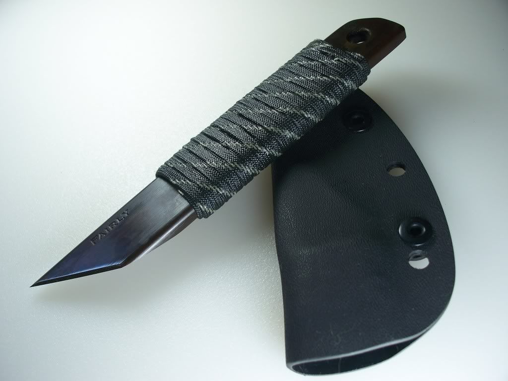

I thought you guys would enjoy checking these out!
I have done my paracord wraps a few different ways; this is the new way I do them. The cord is double wrapped and gutted as opposed to a single wrap of solid cord, I think it looks a little bit cleaner.
The cord wraps are soaked in West System fabric epoxy, they are comfortable and durable.
If you have never felt a soaked handle they are pretty cool, they look like they are not epoxied with the epoxy I use, they have a little give which is comfortable but sound like glass if you tap them, they are really solid.
These two are spoken for.

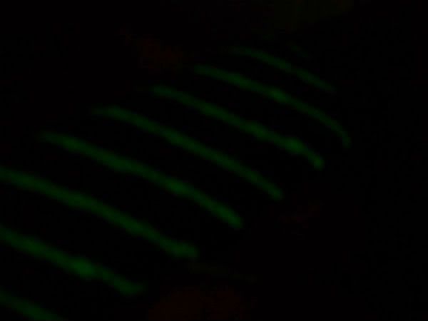

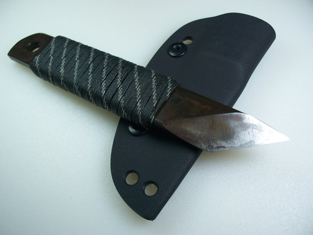

This one is Olive Drab paracord with Glow in the Dark tracers.
Glow Cord!

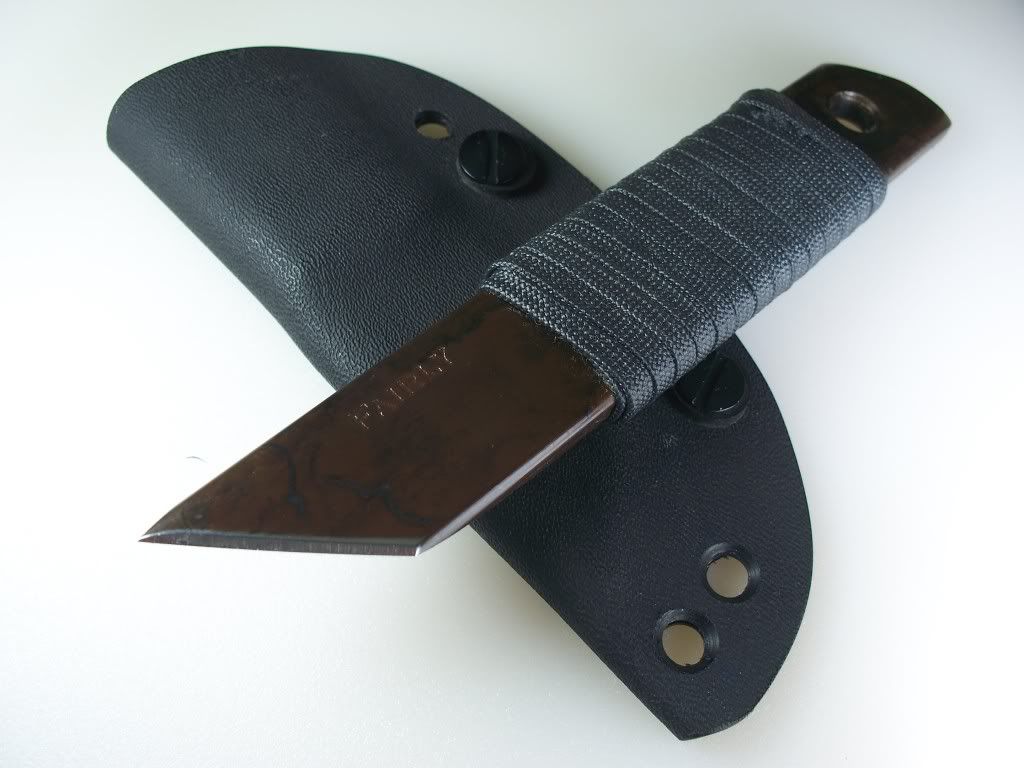

Charcoal Grey - There are a couple of kydex burrs in the photo, they have been removed. :D
