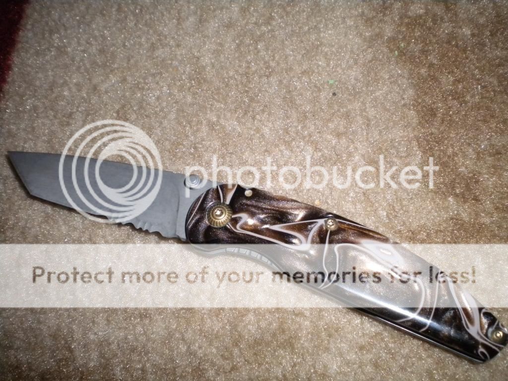

I will post some pics of some new stuff.
Steve covered it mostly.
Honestly 60% of all scale request I get lately are of kirinite then carbon fiber followed by micarta and G10. It is the most popular material that I work with. Pick a good pattern and the knife wont look gaudy.

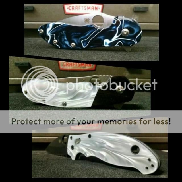

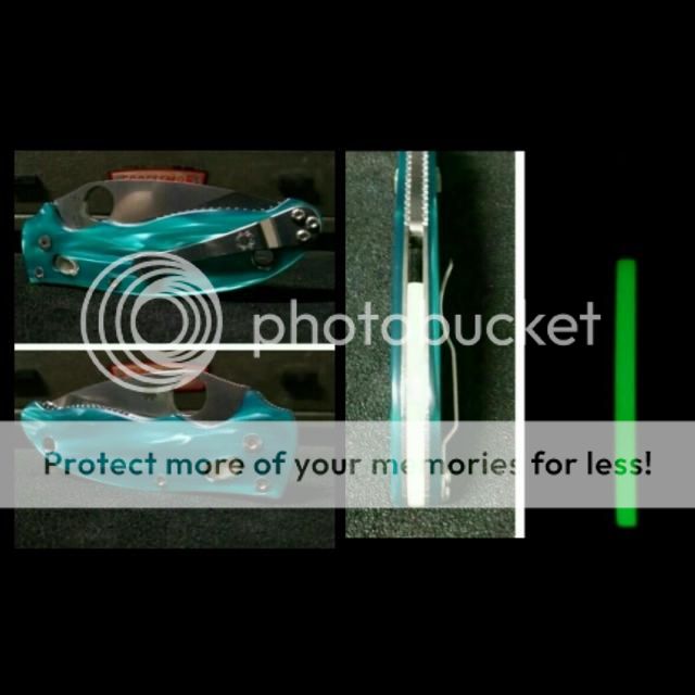

I agree with Matt. If you choose the pattern carefully it can look quite nice. A few of my favorites, including a moonglow backspacer:

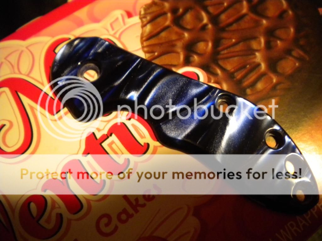

To go with steves, some lava, midnite blue, and desert patterns as well. Oh and a red MOP for the ladies.
