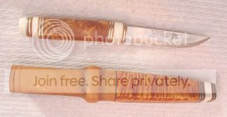

If you are looking for a fixed knife blade,try Ragweedforge.com. He has a wide variety of Scandinavian blades in both carbon and stainless.Start with the basics and work your way up to more expensive materials.Photo of a $10 scandi blade and a couple dollars of curly birch.
