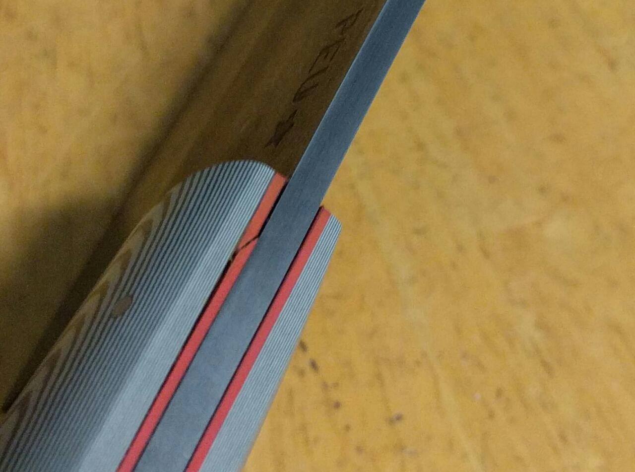

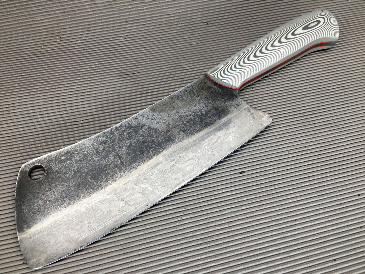

This week I finished a kitchen cleaver for a customer, to assure him it will withstand heavy duty I hammered with it diverse stuff, everything went as expected but, it failed where I less expected a failure, at the handle. The paper micarta unglued I guess due to the vibration, I used epoxy.
I will redo the handle ASAP, but in the meantime, what would you guys suggest to avoid this happen again?
I was thinking in doing 3 holes and using loveless bolts, its going to be a pita to unharden Bohler K720 (O2), but its my best option so far...
Thanks!!

Main purpose of epoxy (besides helping with the bonding) is to keep stuff out from under the scales. You should always use some sort of mechanical means of securing the handle. Epoxy doesn't handle shear to well and that is what the mechanical fasteners provide.
What kind of epoxy did you use?
As to drilling holes, you shouldn't need to soften the steel. Just use a carbide bit. I use glass bits that I get at HD for like ten bucks a pop. Goes through tempered O1 no problem at all.
more, better epoxy!
Drill some divots on the underside of the scales for the epoxy to pool, and clamp *lightly* to avoid glue-starved joints.

You should never use just glue.
Use a carbide bit and put in two Corby or Loveless bolts. Those and epoxy will assure the scales will remain forever on the tang.
Did yo u n glue the liner to the handle scale before attaching them to the tang?
yes I always glue the liner to the scale prior profiling them

local epoxy brand settles in 10 minutes, will try a 5/32"4mm carbide drill bit before attempting to unharden

I always do divots in the scales, the divots always go thru the liner

Open up the holes in the blade with a masonary bit and use the Loveless bolts as you mentioned.
It will not do that again.
Looks like you use pins as well. Peen the pins and it will hold as well as corby bolts. Also, 10 min epoxy is pretty crappy for impact strength. Get a slow cure epoxy designed for impact resilience like G-Flex.
i see 6 pins in the handle, if you put new pins in and dome them, it should hold with out having to drill new holes.
I agree with Rick, I would use some better epoxy, that with your pins--which look good to me--should keep that micarta good for a lifetime.
Everyone here seems to be omitting the importance of surface prep. In addition to all that's being said, make sure you're following the instructions that come with the epoxy.

The epoxy I use, according to the technical data sheeth, you can ad more or less hardener to have the hardened epoxy be harder and more moisture/chemical resistant or softer and more flexible.
I use UHU Endfest.
I don't know if your epoxy works like that as well, you might want to use a different epoxy
Meant to add that I agree with Rick and John on all fronts, here. There's no reason to use anything more than you already have, it just needs to be used right. Peened pins will work.
Also, I suspect in addition to not having proper surface prep, you may also have glue-starved joints. There's no way this should have happened, no matter how much impact it's seen.

Matthew has it right, from surface prep to epoxy...... and with those pins you shouldn't need any other bolts or screws to hold that handle. I think all the other folks missed seeing the pins you've got in the handle - I know I did until it was pointed out by Rick 'n Woodster.
10 minute epoxy just don't works so good!
AND...... don't use a steel maul to strike your blade for testing. At least JB Weld a piece of micarta or brass to the face. Steel on steel is no good. You think your testing the edge but all the stress is on the spine.
