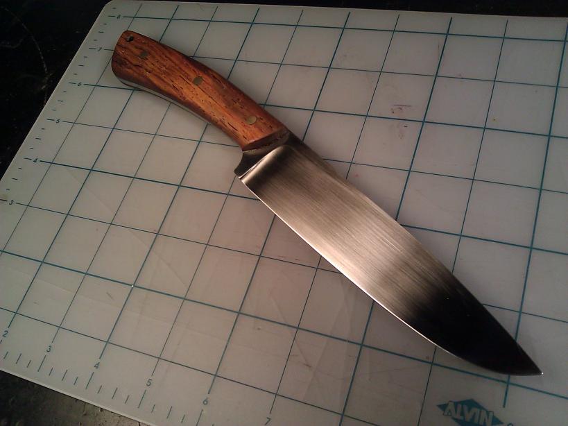

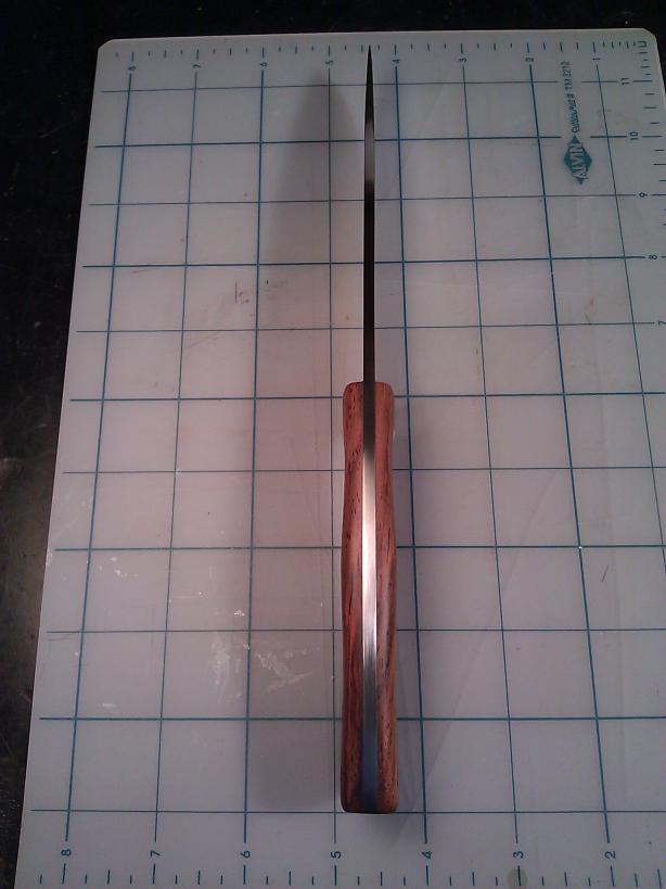

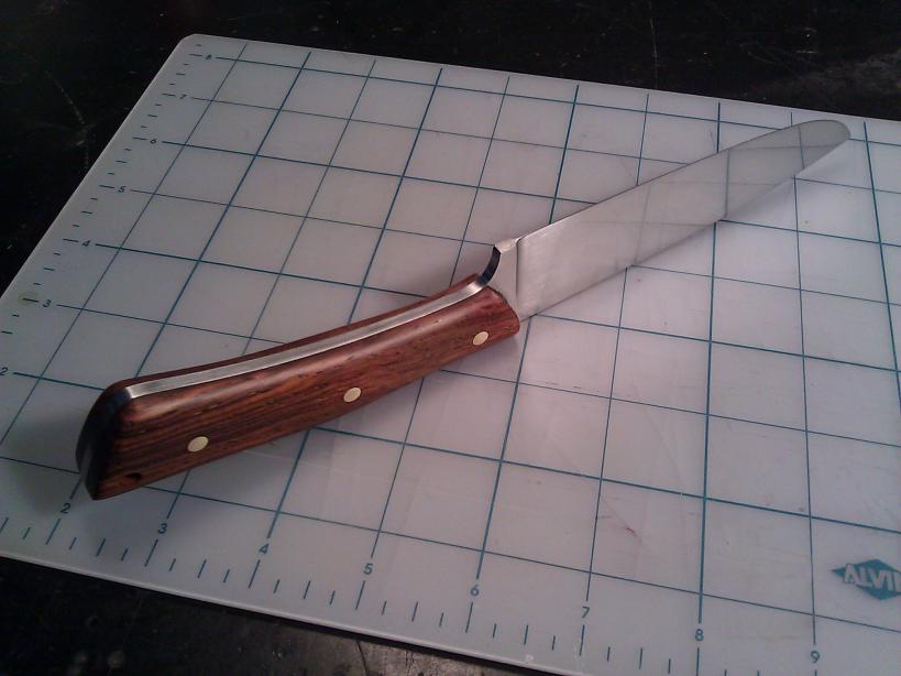

This is my largest design yet.
110% of the original drawing.
Aldo's 1084, ~0.135" thick at the spine.
5.6" blade, Flitz waxed
1000grit finish on blade AND handle

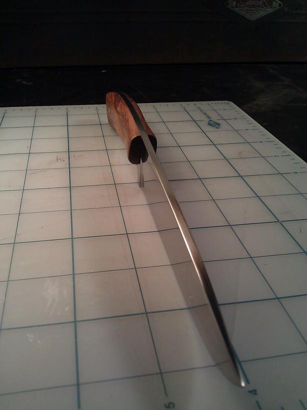

Rounded spine on the drop
Cocobolo scales with 3/16" brass pins
I wanted a knife to slice the ol' 1" free-hanging rope, but couldn't commit to a fighter style, so this hybrid is the result. It's something of a carving knife with a mean-looking tip.
The plan was to rub beeswax into the handle, but I couldn't generate enough heat by hand, so I used a light application of sno-seal instead, which will be nearly the same thing in the end when it dries.
Thanks for looking.
-Daizee

Great looking user there!
The Neats foot oil added to the beeswax will act as a carrier to permeate the handle.
But for Cocobolo, it should have enough natural oil on it's own to polish out just fine. Were you wanting to add beeswax to fill the pores of the wood?
Also, the knife looks fantastic but I see one minor flaw, that once fixed, would improve the look of the knife almost 100%...
The leading edges of the handle scales have a lot of rough looking extra epoxy right where the scale meets the blade. If these photos were taken before it was cleaned, then disregard my critique :).
I've seen more than a few knives that were ready for sale (for a pretty penny too) that had some roughness in that area.

Grizzly, I thought that wax would improve the wood seal, but perhaps not? In either case, I didn't get to putting it on the buffer last night.
The ricasso did indeed have some stuff on it - more wax, stickum than epoxy. The actual wood/steel joint could use a tiny bit of epoxy cleanup, though that itself isn't visible from these angles. Once I've marked it up a bit from use I'll risk going back to clean that joint out to perfection. :)

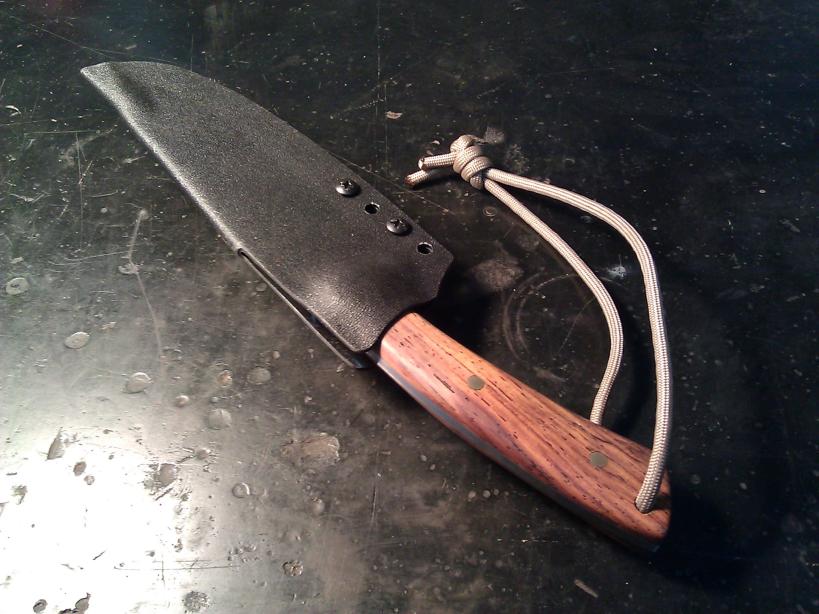

I was getting worried carrying this thing around the house uncovered, so I made a sheath.
The front (at the spine) is cut away to allow the long blade to clear the sheath lower than usual, resulting in a managable draw stroke. Retention is still good. The kydex is a little out of place on this knife, though.
