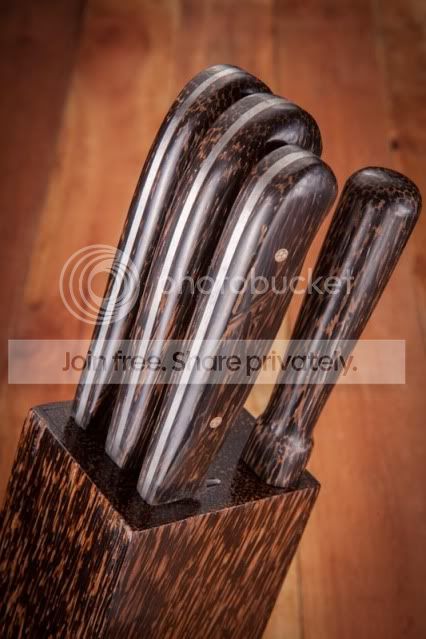

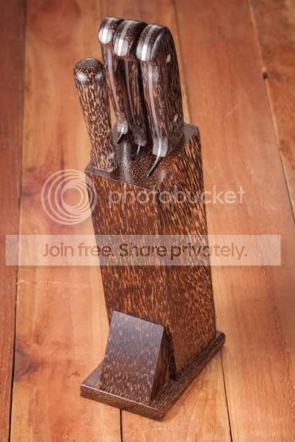

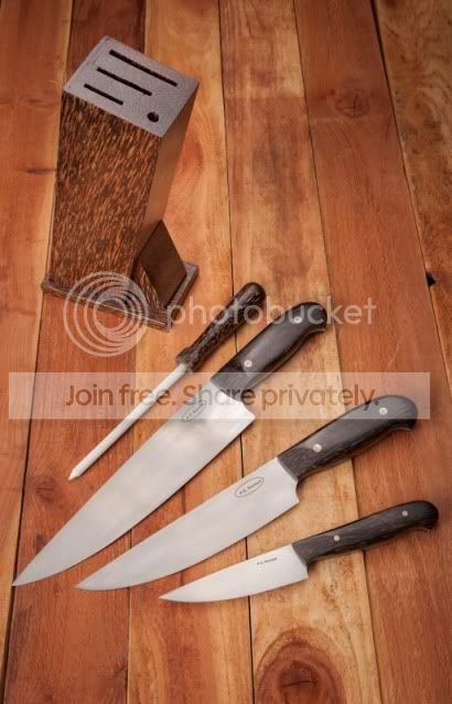

I made this block as a empty box and then covered the top and sides with black palm wood that was 1/4 thick, you can get a number of thin woods which makes construction alot less than a solid block.
I remember being impressed by that setup when I first saw it. Great lookin work Patrick.
There's an idea. Do you not have to worry about the blades contacting one another with just the face as a seperator?
The face is about 1/2" thick and the gap just wider than the blade, it holds pretty well and they really don't have much side play. You can alway add a seperator in the box in you like. This construction allowed me to use the same wood in the block as the handles but without the cost. The thin cut woods are not real expensive depending on what you choose.
