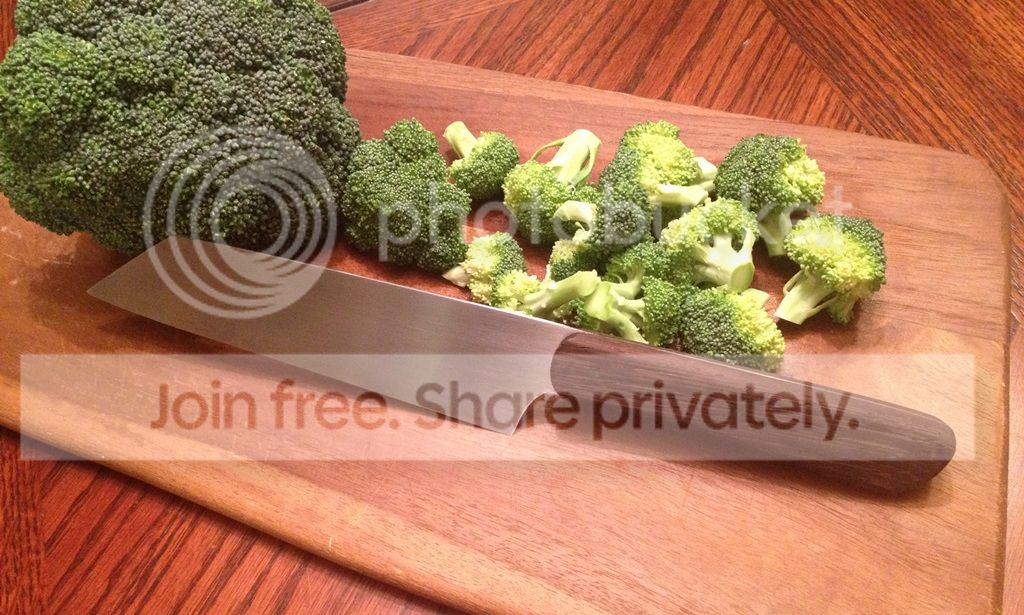

You might want to draw it with a 1" longer blade and see how it looks.
I made a kitchenknife that looks a bit like your drawing and exactly as Butch says I wish I would have made it a bit longer. app 6" would have been better
yep you can gain 2 inch easy with a stick tang. they can be intimadating for a new maker but if you make the "guard"/fron of the handle out of a strip of micarta 1/8 thick you can file the slot fairly easy then you can make the back of the handle a looser fit and fill with epoxy making for a great handle
Hey Salty,
I have 0.065" 15N20 and 0.094" 1095 both from Aldo if you want to ride over to Mobile. I think you'd be much happier starting with thinner stock. Plus it would be cool to meet another new maker in the area. I made my first kitchen knife, which looks very similar to your drawing, from the 15n20. It was easy to heat treat (similar to 1084 but with a lower temper) Using my test files I believe it's in the 60-61 range. I've been using it almost daily for a month and haven't touched the edge.
