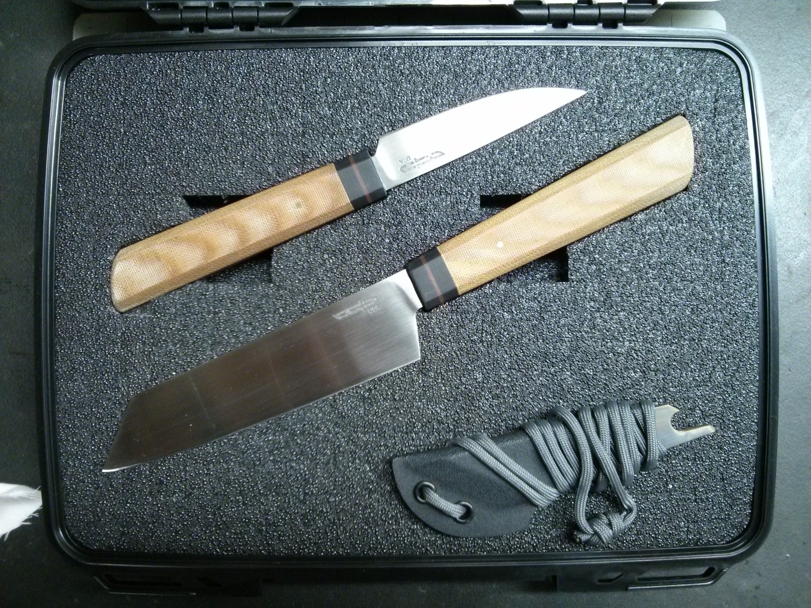

I'm working on a 2 blade kitchen knife set. An 8" Santoku, and a 3" paring knife. Both will have matching ironwood burl handles. Anyways, I've only ever made one other kitchen blade, in which I sold without a sheath. What would be the "normal" or best way to store/ship these? Thin leather slip sheaths? A slotted wooden block? I'm not sure how to go about this.

Thats what I'm afraid of but, I was thinking of maybe trying out just an edge cover thats maybe only a 1/4" tall, and forming the kydex tight from the tip, to the back point of the edge. So it could be sort of snapped on. But we'll see. Thats just what I quickly came up with in my head. I'll think of something. I should have the knives finished tomorrow afternoon.

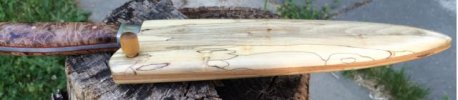

I made a saya from a chunk of spalted maple I had. I cut two pieces on my bandsaw a bit over 1/8" thick for my outside walls and then a piece of alder (softer wood) about the same thickness for my center. I traced my knife onto the alder and cut out the knife shape a bit over sized so the knife would fit inside. Glued the three pieces up like a sandwich, did a bit more shaping and sanded and finished it. Hard part for me was getting the pin nice and snug in the right spot. You can see the alder piece in the third picture.

RandyB, that is a great looking Saya. I like the shape you went with, I'll be stealing that idea on one of the next ones I make! I love spalted maple, that's a great use of that piece. What are the handle scales on that knife?

Thanks Fish. The scales are maple burl. I spend a lot of time in the woods and have a fair bit of wood that I have collected in the last few years for flute making. It's sort of fun when it is reclaimed wood you found for free! I just had to send some out for stabilizing.
This saya was easy to make. Basic basic woodworking skills needed. If You can attach scales you can make a saya. It was Stacy who got me going on making one. I'm happy I did.
A good method for positioning the peg hole in a saya is to glue up only one side and the core first.
Set the knife in the recess and make a 1/8" starter hole where the peg will go.
Glue up the other side and drill the starter hole through the second side.
Shape the saya and finish.
Once all is done, enlarge the holes to fit the peg and retain the blade.
