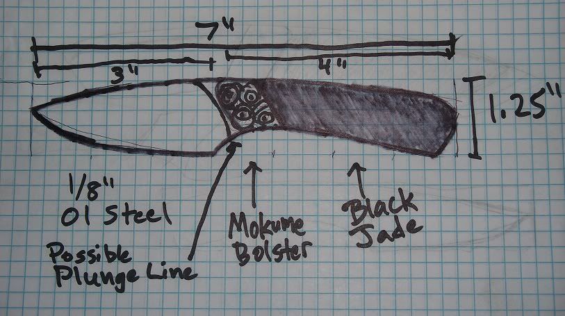

I have been trying to come up with a good KITH design and I think I have it, here are my plans so far, my awesome drawing has a lot of the information. :D
I have some really nice Australian Black Jade for the scales. I bought some Mike Sakmar 2 color Mokume Gane for the bolsters. The Jade I have is known as the toughest stone there is and looks great also.
I'm considering hidden pins or lots of glue rivets for attachment, I'm still not sure. I can drill the Jade and Mokume but I'm still not too sure about pins.
For the steel I'm using .125" thick O1. I plan on a plungeless grind or one with a ricasso that allows for a fully sharpened edge as shown in the drawing. It will be 7" long with a 4" handle; 1.25" tall.
What do you guys think, I appreciate the input. I promise the knife will look better than the drawing!

In all seriousness. Is this a plungeless chisel grind? Or will this be the debut of the patented fairly "Double Chisel Grind"??? ;):D
It sure looks good on paper. love the blade shape. I'll make sure bladsmith gets my address.
Looks awesome Daniel! I think 6 or 7 3/32" pins domed with collars would look awesome on it. I forget that you are a rock hound, any chance you might offer something with stone in your regular lineup?
It will be ground on both sides, for the KITH I decided to go double chisel. :D I used to grind them on both sides and still do an occasional one.
I just tried this grind on a cleaver and I love it, it is easy to sharpen and has that smooth geometry that I'm liking more and more.

I was reading more about the Jade I have and it was compared to Ceramic Zirconium in toughness, tough stuff! I have cut a few cabs and re-scaled a Buck 110 with this Jade and it looks great, it is pure black and takes a great polish. Jade is known as a tough stone to work, it has a tendency to "orange peel" but so far this jade has been a pleasure to work with.
