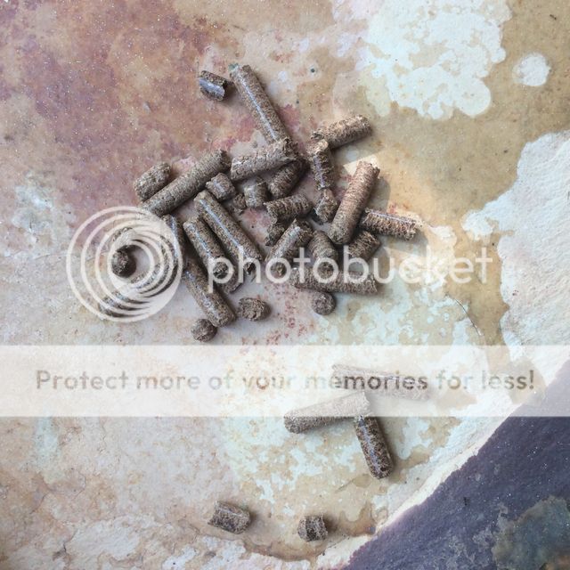

It is cat litter made from compressed wood and I have been told it works well in wood burning portable stoves.
I tried it in 4 stoves and had good results with 2 of them. The pellets were easy to light using some bunched up bamboo leaves that cover much of my yard.

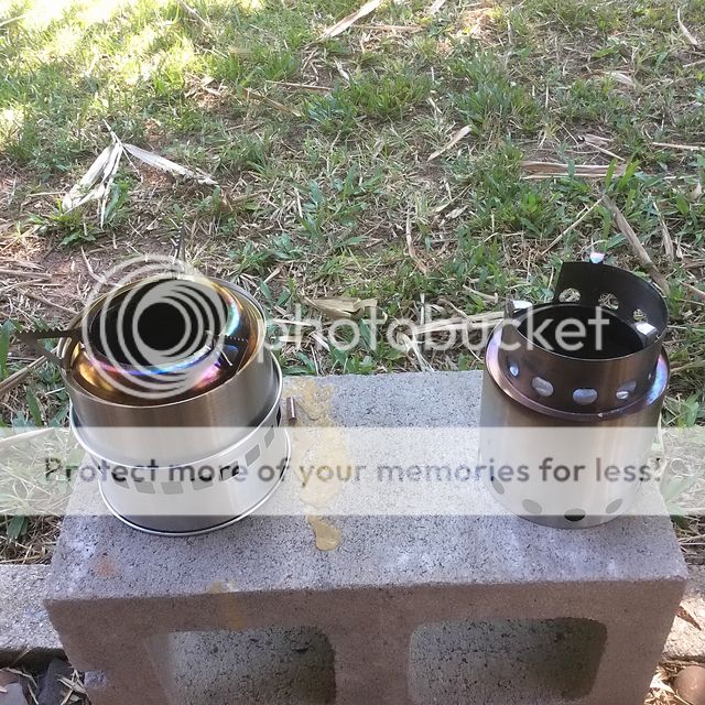

The first attempt was in two wood gas stoves. One was a Solo and the other a no name clone that was given to me and had not been used before.

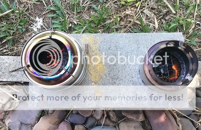

One of the advantages of wood gas stoves is that they give off very little smoke and this held true with the pellets. The no name worked vey well and gave off a good flame for over forty minutes with a relatively small quantity of pellets.
The Solo worked ok but the course mesh in the bottom allowed pellets to fall through.

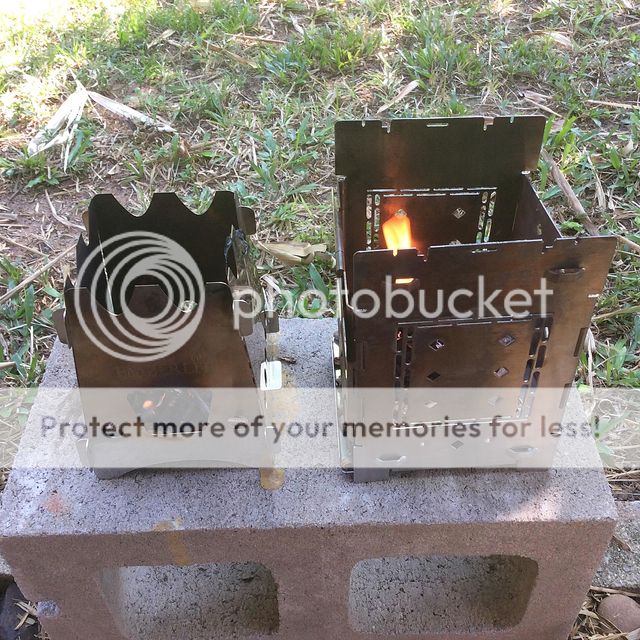

The next attempt involved an Emberlit and a Firebox. The Firebox worked well though there was some smoke. The Emberlit wasn't a success. The solid base didn't let any air under the pellets and it smoked excessively until I eventually put it out. The stove would need something to hold the pellets off the bottom to compete with the other stoves.

Neat experiment! I sometimes use hickory chunks meant for smokers, from the box stores. Hickory is one of the cleanest buring, high BTU woods known in the U.S. One bag goes a long way. And our new Cabellas opened the other day... I noticed they had a wide variety of chipped smoker woods. I'll be picking up a bag of one variety or another to try in my Emberlit and TOPS twig stoves. As for using the little pellets, you might add a small mesh square to the bottom of your twig stoves, edges bent down at an angle to provide air circulation.
You're right about needing something under them, especially with the Emberlit. The irregular form of twigs does this for you but the pellets just pack in on the bottom.

If the grate is too course, try putting the pellets in a aluminum cat food can with holes punched in the bottom to suit you (Some trail and error may be needed.)
Sawdust pellets (AKA "wood pellets") are sold in nursery stores in large bags for pathways and mulching - much cheaper that those sold for litter.
