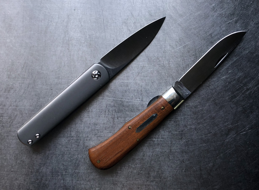

@miso2 Check this out. I recently sold my Boker Exskelibur framelock to a good friend so I needed a new knife to replace it as my larger front flipper. I got this Katsu Titanium framelock to take over this role. Check it out, I cannot believe how cheap it is for what you get.

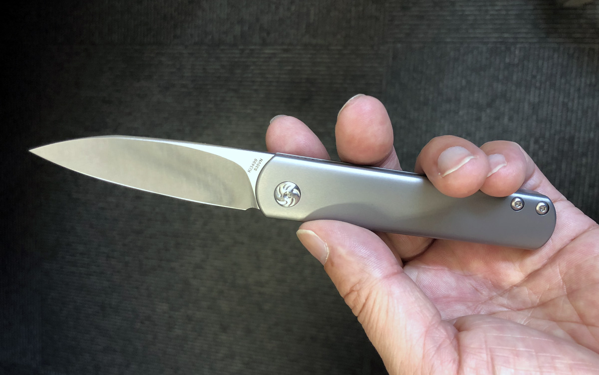

It is quite a large knife but outstandingly built for the $100 price tag. If I was more of a 4 inch folder type of guy I would be carrying it all the time. As it stands it is abit of a safe queen but serves as a constant reminder of how beautiful and perfect a knife can be made for 100$. It is an even better value than knives like Kizers with a construction that is atleast as good if not better. One thing I noticed is that the knife is wider than it has to be as there is alot of space on either side of the closed blade between the blade and the scale.
I actually anodized the clip purple which doesn’t show great in this photo.
As for the feist it just barely fits as a 4 finger grip and I have size L hands. Still I wouldn’t want to stab with it.

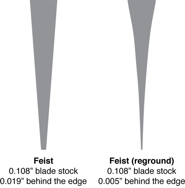

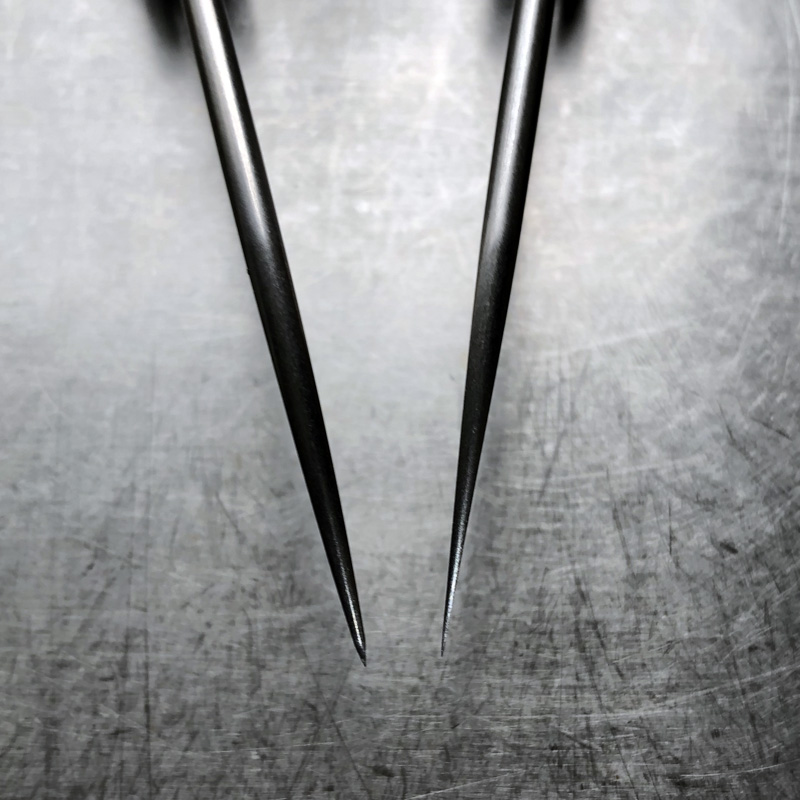

The edge is now very very thin.
I cannot measure the thickness behind the edge accurately with my caliper.
It is almost zero-ground.
The original blade was not too bad.
But the reground blade easily sinks into thick medium like cardboard or carrot.
What a performance boost!

From left, Boker Exskelibur, Feist, Sebenza.
