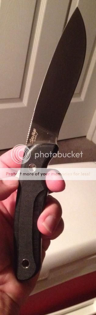

I have a Kizlyar Savage in D2, and while I haven't cut anything with it yet, I did make a point to get the D2 version because it seemed like a shame to buy a nice knife with a lesser steel when better steel was available for a little more money. That was my reasoning, anyway. The workmanship on my Savage is excellent, and I have considered picking up a D2 Delta eventually.
Is it sharp, I mean D2 is generally sharp and how are the grinds and all that?
Oh yeah, it's extremely sharp. I've been fortunate that most of the knives I've bought over the years have been as sharp as I would expect, but I wasn't sure on a knife coming from Russia. The grind on my Savage is perfect. Based on this purchase, I wouldn't hesitate to buy another Kizlyar, a fixed blade anyway. I have no experience with their folders.
