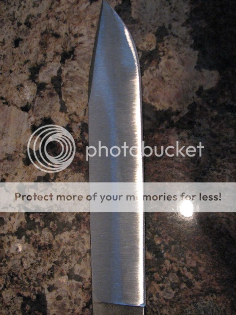

Just got my order from pops supply, outstanding :thumbup:!!!!!
I switched from Blaze to Klingspor to give 'em a try.. so far.............................
I love them !!!! 36 grit seems to be really holding out, of course I just used it a little today to grind out some 1/4" 5160 and it seems to hold its grit better then the Blaze belts at almost half the cost :eek:
I will post an update once I burn through the rest of this knife hopefully by the end of the week..
Has anyone else had good experience with Klingspor?? I may have just found a new belt !!:D

Yes I'm talking about the blue zirconia cs411, maybe it was just me but I burned up 2 36grit blazes pretty easy.. maybe everyone just talked them up so much I was expecting more out of them??:) I dunno, could have also been that I applied so much pressure causing them to prematurely wear??
I bought multiple step grits so we'll see, but so far its holding its grit really good, not much has come off... I too found the blaze belts to wear really fast at first, however they still cut just not like they did the first 5 mins.. :D
I've done 2 of these knives, blades are 11" ffg, my blaze did one complete knife but had lots of wear.. I ground this blade on both sides and the blue zirc doesn't seem to show as much wear.. my blaze belt profiled and roughed it though....

yes the knife above was profiled with an older 'used' Blaze belt, and I started my edge bevel and the full grind with the blue.. Next time I'll try to take a used 'dull' belt and do my starters also..
no offense taken, I'm still an apprentice so everything is a learning curve, and I'll take any tips, anytime, especially if it will help me save money:D
