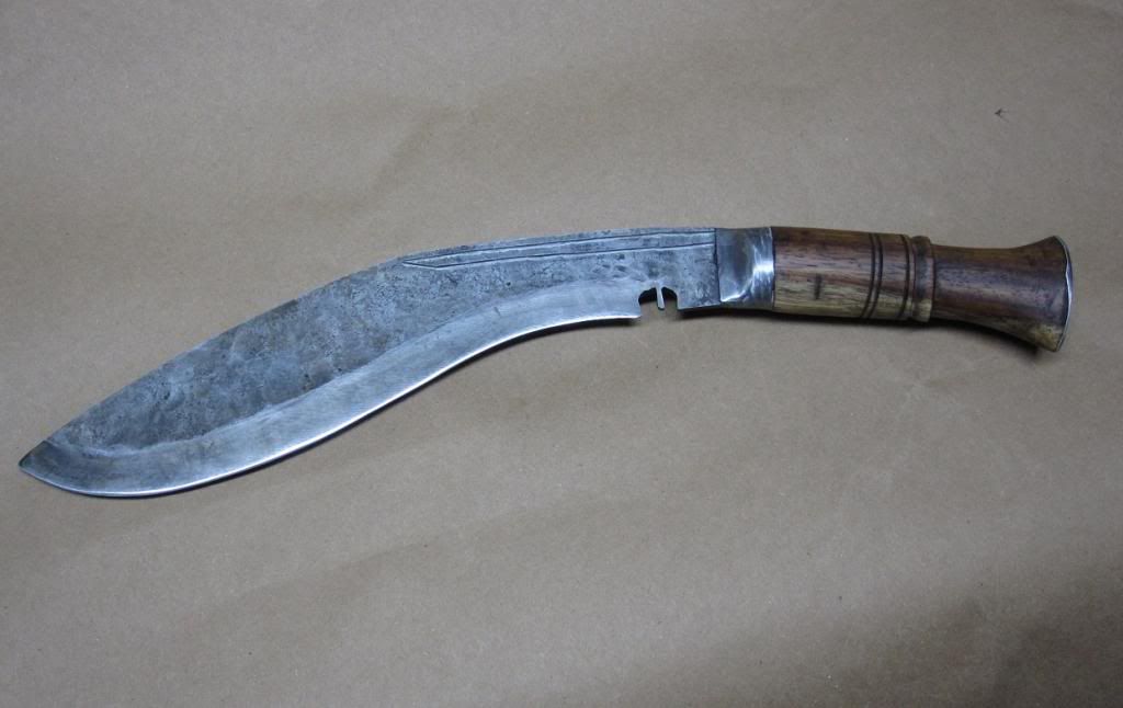

I know some of us like the forging scales left on the KLVUK's however if one wanted to remove that so you could force a nice dark patina. Would it be worth it and how would you do it?
Super easy to do. I did it on my last one and I know a couple other guys here did too. I used apple cider vinegar but any acid will work.
And how do I get the Black stuff off? Just wire brush it off?
I am not sure what that is called actually
No scrubbing required but you can if you want to speed up the process. Just soak a paper towel in vinegar, wrap it around the blade carefully with minimal gaps/wrinkles, and let it sit for an hour or two. Rinse it off, wipe it down, dry it, and repeat until you get it as dark as you want. This one took several soaking to get so dark:

I'm one of the other guys. I was shocked. I tried a little scotchbrite pad for fun and it didn't even phase the stuff, I thought I'm not going there.
Tried Philllls (did I get the L count right?) apple cider vinegar trick and it was gone. I just soaked a paper towel with the vinegar (foul smelling stuff) and made sure it had good contact all over the blade on both sides. Just a single layer. Any spot not touching will leave a spot. Just let it set for about an hour while I did some other stuff and then like removing the bandages from the eyes I expected to see a need to do that at least 27 more times. NOT SO. One application and it was gone baby gone!
I did it a few more times just to add patina and it made me feel powerful but didn't need to.

The more I look at it, the more I really dig that scale-off finish, and I'm glad I gave it a try:) My KLVUK has become my go-to khuk. I used it all winter to split kindling, limb some trees, destroy the Christmas tree, etc.
