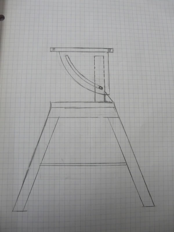

Sorry, i should have been a bit more specific. The engine stand i have has a hand crank wheel to turn it over. It is a TON more sturdy than a standard stand. It also takes all the beefcake work out of tilting an engine :P I am looking into doing a map arm also and did some design work to flip my KMG
on it's side. If i can before work, i will post a pic....Could also build something stand like that tilts like the TW90....more thoughts lol
Maybe a stand kinda like this, i am sure someone will have a better idea/upgrade to this, but you have piqued my interest, so i am going to start building something like this this weekend. To keep in the nature of Rob's beast, i will use 1/2" plate steel to make the base(Where the KMG bolts to) and probably 1/4 or 3/8" plate for the tilt panels. Just a thought but it might not be a bad idea to counter weight the right side, as the grinder will tilt to the left, putting all the weight to one side.....Just another thought, but i will try to post pics when i build it....Have to have the tilt guides plasma cut, luckily i have a buddy that happens to have one :) I will make a new post when i get into this...
oops, posted this without adding the picture lol
So...here is my idea...
or just mount the grinder centred over the pivot instead of off to the left like the drawing shows.

that might work pretty well. I'm hoping you plan to have 2 vert post, one front and rear. It will help with rigidity. Pay attention to where your pivot point is so your work height remains nearly the same.
This is important.
I've built a couple of horizontals lately, and am in the midst of designing a pivoting system for my vertical, and the height of the 2 configurations is my hangup at the moment.
I find a comfortable height is more critical on the horizontal, as you have less of a window to play with.
You have a little more leeway with the height in the vertical position.
Keep in mind I haven't put any of this into practice, but the method seems sound.
I determined the pivot point by measureing my comfortable working height from the baseplate. The pivot point needs to be that distance left of the left edge of the belt. The further right of this point the lower the machine will be in the horizontal position. I would think that a little too low (within reason) in the horizontal position would be easier to get comfortable with than too high.
That's pretty much how I have mine drawn up right now little mac, with the exception that I measured my sweet spot from the center of the belt, and the centerline of the verticals tooling arm.
4" over, and 4" down gives me the same height on the center of my belt when it's horizontal as the axle of my wheel when it's vertical.
I actually prefer a little too high on the horizontal, it keeps me from stooping.
I just raised one of mine up a couple of inches because of that.
It was killing my back, and since I am usually using a rest on the horizontal, it seems easier on the body to have my arms up a bit.
The centerline of my horizontal belt is now 1" higher than the centerline of my verticals tooling arm.
