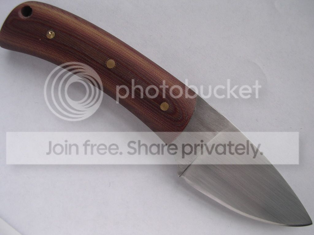

Here is a picture of a knife I made I think somewhere between the belly on this, and the belly on that would look good on that design.
What would be the advantage of one belly verse the other? Is it an aesthetics thing or function?

Both, but a more swooping belly is more functional for me(for the way I use a knife). That is much better. Apply Mr. Niro's suggestion, and you'll have a good, functional knife.
What would be the advantage of one belly verse the other? Is it an aesthetics thing or function You ask? I think your original design could be perfect for one size- shape hand for a few specific jobs. If this is what you want to achieve – like a perfect fit for you- in the shop, - then it works. The design may force the hand close to the blade.
Some jobs some hands might require sliding back on the handle further for better balance comfort and some jobs might require, maybe swinging the knife needing the hand to be far back on the handle. Due to these uses for knives the design of the belly is altered to suit the various needs. Much is simply up to you, and developing a style of your own you might get known for, or that suits specific knife needs people seek you out for. It’s good to at least understand the potential and why you design it a certain way. Looks like a good start and looks like you enjoy it, so keep up the good work!
