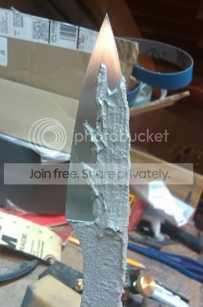

knife #2 ready for ht
Sep 2, 2008
47

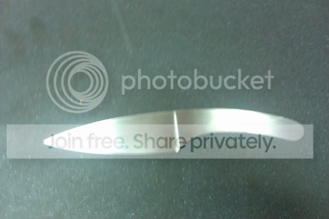

This is a small kitchen knife made from 1095. It's 8" long with an 4.25" blade. I've sanded it through 400 and it's ready for me to HT tomorrow. Comments and critiques are welcome (no matter how rough they may be). I'm still learning so critiques really help.
It will have scales, i just haven't decided what to put on it yet. I have to Heat Treat it first.
Yes it is flat ground with a distal taper from the start of the blade to the tip.
i was getting ready to put the satanite on and realized i hadn't put holes in it for the scales. So the holes aren't in the first pic. They are filled with satanite in the second pic. It's all part of a learning experience. This knife is going much quicker and smoother than my first one.
