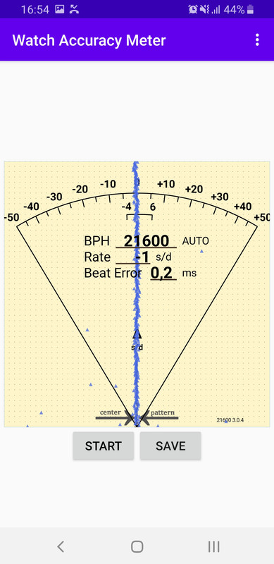

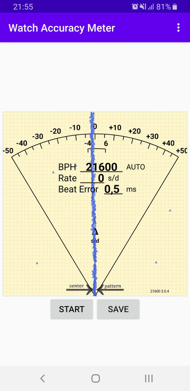

In under half an hour I got it pretty much dead on accurate. Three screenshots of subsequent measurements:
The line of measurement points starts at the bottom of the display usually somewhere to the left or right of center. Swipe the screen to center it between the arrows.
4 days later it's still within 2 sec per day. If I have to do this every couple of months it's no big deal.
