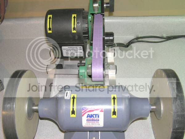

I have that exact buffer and it's used with paper wheels.
*Note - the motor is turned around so that the wheels spin away from me but the switch is still in the front.
It's a Baldor and it's got mucho torque so that's not at issue.
Even though the buffer itself runs incredibly smooth the paper wheels never do no matter what brand or how much you balance them.
At the lower 1800 rpm they will wobble a bit and they sharpen and polish slower. I bought the same set up (from another source) thinking the lower speed would be better for heat control. I also thought that these wheels would work at the same speeds that a buffing wheel would. Over time I've found that all the manufacturers recommend using a 3450 rpm grinder (or buffer if you prefer) with their paper wheels. This must be for a reason.

I have used the wheels from "Razor Sharp Edgemaking" on the 6 in. grinder mentioned in Dave's post. The guards come off easily, and in fact, by removing a couple of bolts, you can flip the grinder around on its base, so the wheels turn away, and the switch and light are in the right position. No other modification is needed. The wheels come with a bushing so they will fit the grinder.
