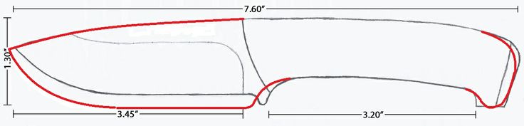

This is an image edit I did for another member here, but I think is kinda the quintessential hunter/outdoor/general purpose knife shape more or less (the red line). Like Hesparus said, no finger grooves unless you are intending for the blade to be used in only one hand position. Same for the American tanto tip as well. It does work extremely well as a penetration device, hence why a lot of makers use it, but not ideal for a general purpose knife.
