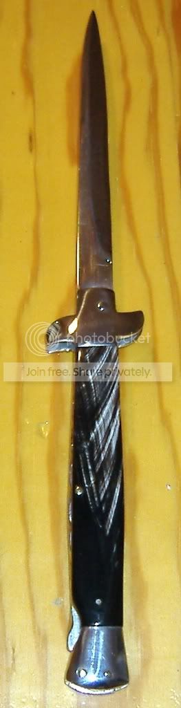

i use a cad program that I got free from the company that cust my metal, It is there program to use with there machine, but it is great!!!
I make Italian style switchblades and use it to draw up my knifes. It lets me check for collisions and it makes the tollarances just perfect I draw the knife with everything on it hammer and blade then copy one or the other and when it gets back to me they fit perfectjust a little sanding. I have come up with a few new designs that work pretty goodhere is one that is a lockback 3/16 blade thickness in 01 toolsteel, 1095 backbone and kick springdark waterbuffalo horn with solid SS bolsters and SS liners. I use the program to make my own fire button and sear pin also, and the tooling I need to bend them into shape

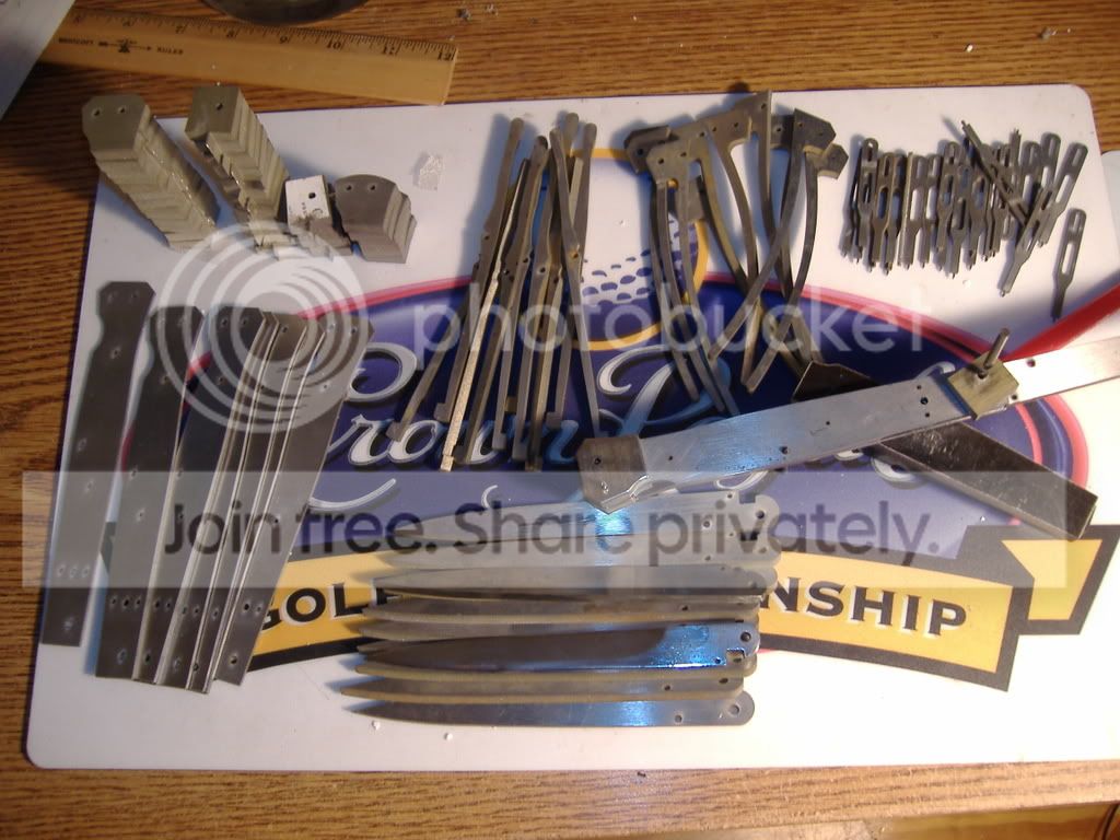

I use a cad program that I got free from the company that cuts my metal, It is there program to use with there machine, but it is great!!!
I make Italian style switchblades and use it to draw up my knifes. It lets me check for collisions and it makes the tollarances just perfect I draw the knife with everything on it hammer and blade then copy one or the other and when it gets back to me they fit perfectjust a little sanding. I have come up with a few new designs that work pretty goodhere is one that is a lockback 3/16 blade thickness in 01 toolsteel, 1095 backbone and kick springdark waterbuffalo horn with solid SS bolsters and SS liners. I use the program to make my own fire button and sear pin also, and the tooling I need to bend them into shape this was all drawn up on my computer:)
Nice knives! I love that style. After I have some experience under my belt, I'd love to take a crack at one of those!
