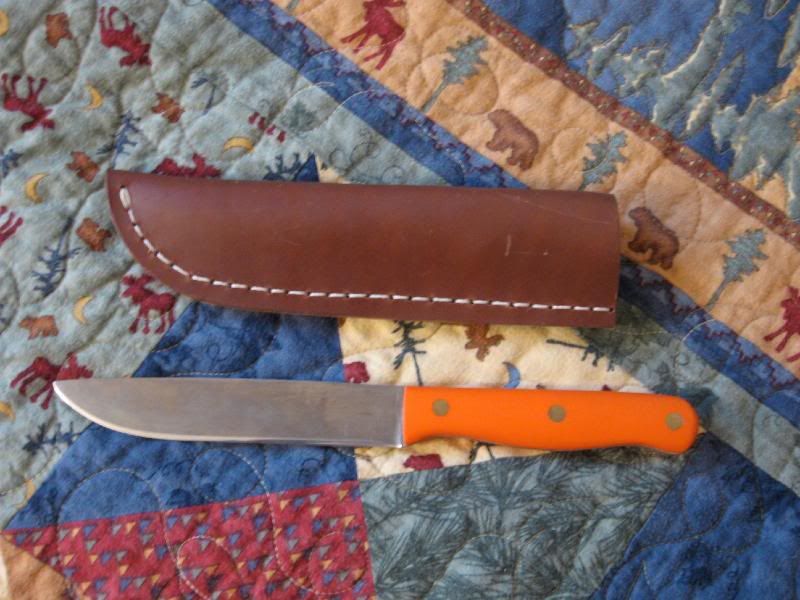

I actually designed an all-around fishing/fillet/light camp knife a while back. Everybody's probably seen it by now, but this is it:
5.5" blade, 4.5" handle, Orange G-10, and 3/32" stock. This one's from Bryan Breeden.
Quite frankly, I don't much like palm swells on any knife. The handle on the knife above is secure enough for anything I'd use it for short of stabbing something really tough. Canvas micarta would be good, though. I will say that Bryan finishes his G-10 a bit rougher than most, which gives it quite a bit better grip. That might be another option.
It's also made out of O1 steel. If you're going to be going to salt water, and not cleaning the knife off much while in use, you're probably right to go with a stainless steel.
