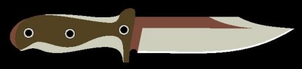

This is a quick sketch I did of my Becker BK7. I didn't do any measurements... I just made estimations. I think this actually looks more like the BK9. This took me about 15 minutes.
