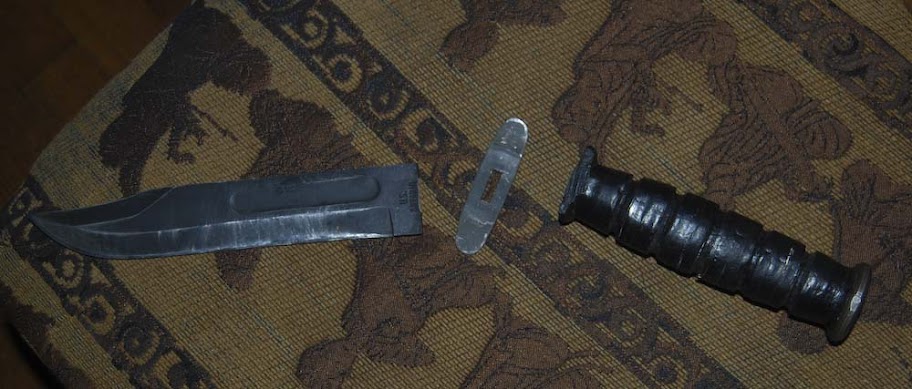

To make a long story short, I was outside doing some light battoning to get some nice sized wood to heat water over the fire. I was using an Ontario made Kabar type knife, not the best for the task, but all I had access to. As I seem to be rambling I'll just say the knife snapped under very little abuse. I was not hitting it hard. A simple failure made a task like heating water that much harder.
From now on I think I'll trust my warmth, and my fishes lives for that matter to a RAT RC-6 when I can scrape together the cash.

Very early on makers realized that steel is more brittle in cold temps, axes chipped on frozen wood and knives broke in cold weather, the rail roads realized this and remembered that steel must be tempered in balance to the temperatures it would be used in. Many have forgotten, I hope this is a reminder to all that blades need to be developed in harmony with the environment they will be used.
Read this:
http://www.barkriverknives.com/docs/batoning.pdf
Short version: be careful to hold the knife horizontally while batoning - if the handle is allowed to tip down, it can cause unusual stresses at the base of the blade when it is struck by the baton. Even good knives can be broken this way.
Thanks for this, it was a good read. Good will come out of my loss yet if someone else that hasn't seen that and reads my thread.

I must have missed when this furious, feverish desire to baton a knife caught on. It seems like every fourth post is about somebody using a knife to baton through something or other. I honestly don't understand this sudden surge in a practice that was at one time considered controversial at best. (This is not a criticism of the original poster, who had a specific situation with which to deal.)
That said, why was this knife the only one to which you had access, if you were home? Wouldn't you have an axe or hatchet at home? (Correct me if I am misinterpreting.)
The orginal poster has said the knife broke "after only a little abuse." Well, that's the key, isn't it? Abuse. If a knife breaks when using it for this, or for prying, or even for, say, digging in stone-filled ground (another task for which it is not designed), it hasn't "failed." Failure implies that the knife stopped doing something it was supposed to do, something for which it was designed.
This knife broke while being misused. That's not "failure."
Soapbox dismounted. I'm glad your fish survived.
Any decent fixed blade knife should be able to baton wood all day long, for eternity without breaking. For example, if you purchased a RAT, I guarantee it would not have had any problems (I don't own one, just speaking from reputation).

Most fixed blades are not, in fact, designed for that, though of course there are plenty that will. I don't think it's a reasonable expectation, in general, of fixed blades as a category.
That "batoning theory" .pdf makes little sense to me.
Whether or not the handle is horizontal, is irrelevant. The force experienced by the tang (provided the handle is held immovably) is determined by the angular acceleration imparted by the blow of the baton, and that is largely determined by how far (very loosely speaking) from the pivot the blow lands. If the blow comes in perpendicular to the spine (no matter the blade orientation) and lands at a point in line with the pivot, the angular acceleration and the force on the tang are negligible.
What I find interesting about this whole topic is that the resisting force of a human hand holding onto a pretty short lever is sufficient to snap the tang on a supposedly tough outdoors knife.
Judging by some knife blank profiles you see from time to time, it seems not every knife maker appreciates the value of radiused corners and thick tangs, opting instead to cripple a design with stress raisers and rat tails.
