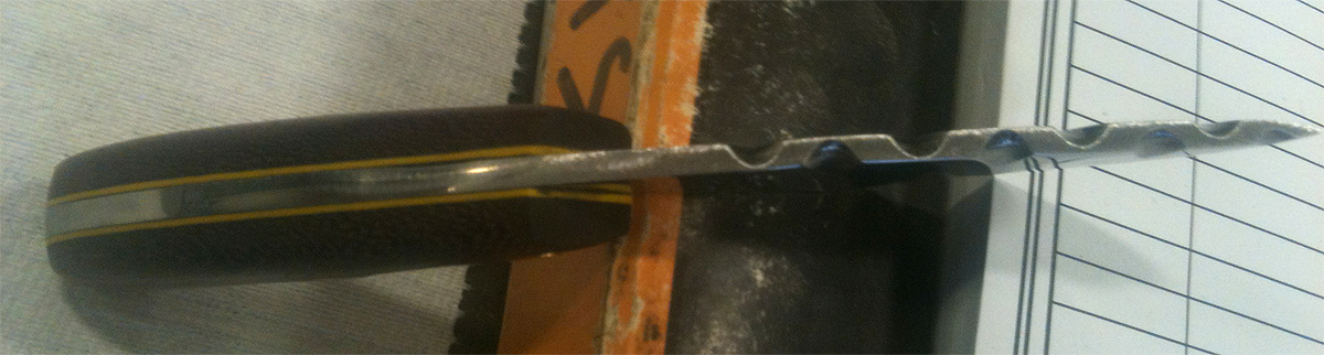

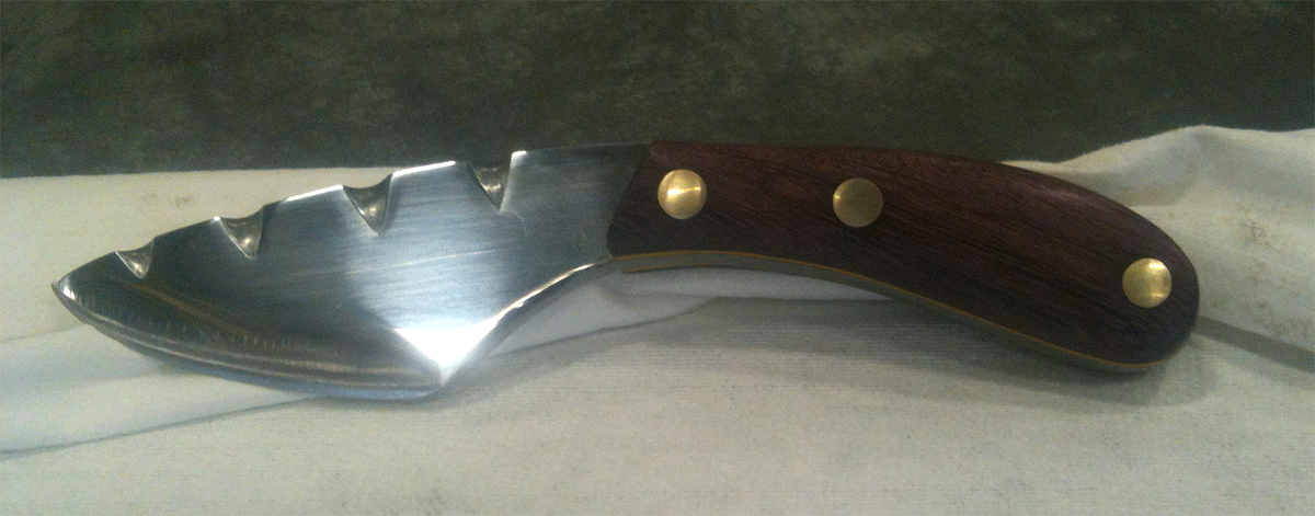

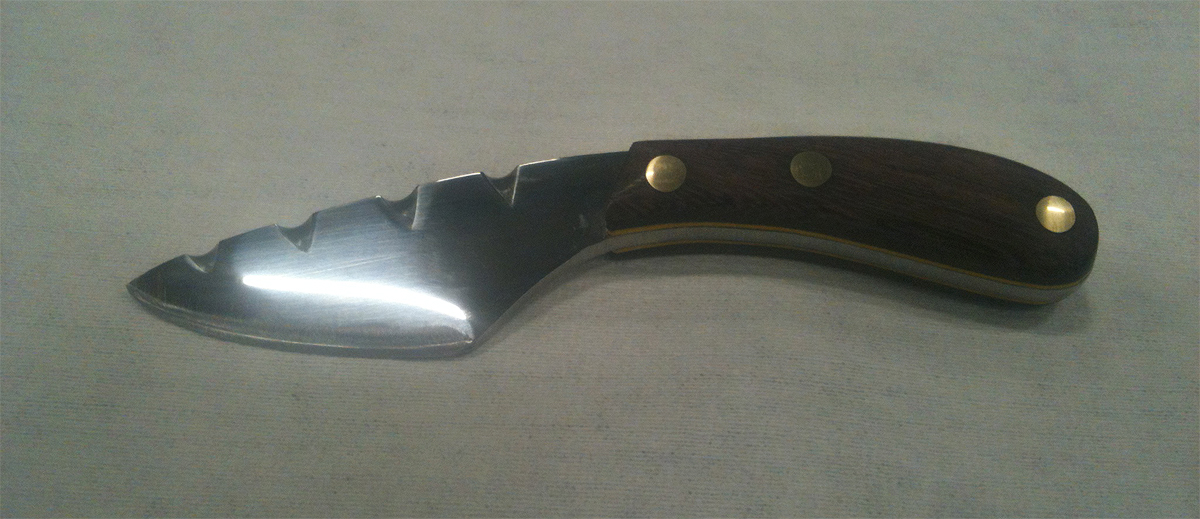

Knife for a friends birthday. Second try at "filework".
Jul 19, 2014
92
It's 1084 steel, with Purple Heart wood for the handle, brass pins, and yellow G10 liner. Honestly this was just a small scrap chunk of steel I didn't want to waste, so I kind of just designed it as I went, working with that small piece however I could.
I was always intimidated by that nice look you get from file work, but I tried it once, and it turned out ok. So I tried it again here, and while it isn't perfect, it looks pretty decent IMO, gives the knife some extra style. (Though perhaps compromises it's integrity?)
I still have some trouble getting that "shaving sharp edge". This will slice paper nicely, but it won't push cut, nor will it properly shave your arm hair. I know the bevel is shallow on this one, but it's a problem I have with most of my knives. I don't know if my geometry is way off, or if I simply don't know how to use a whetstone or what, but my knives aren't as sharp as I'd like.
I have a feeling somebody will say that first pin is too close to the edge, because I thought so myself. I just removed too much material on the handle though and it couldn't be helped unless I wanted to totally redo it.
Anyways, I am fairly proud of this, I am making good progress finally but I have a long way to go.
(Taking proper pictures of knives is hard... I know this isn't a great knife, but the pictures really don't do it justice...)
I'm pretty green, but here are aome things that stick out to me. My first tries at file work were really basic, like yours, but I wouldn't bring it so far down the blade. Look up how to do the "climbing vine" it's relatively simple and looks very neat. Also pins aren't spaced symmetrically. Is your handle material flush with the tang? It looks like the metal dips below your wood. If you don't already, shape the handle on the knife, once I learned that the hard way, it really helped. What are you grinding your bevels with?
Overall, it is a good early knife.
Nic pointed out the major things:
The file work is far too large and comes down the blade side too far. This makes it a detraction, not an embellishment.
The handle needs some rounding. It should be an oval or egg shape cross section. Pins should be smaller and evenly spaced.
The blade bevel got "washed out" in sanding and buffing. It should be crisp and flat, not rounded. The reason it won't cut right is it is too fat behind the edge.
You didn't mention HT. What was the steel type and the HT?
