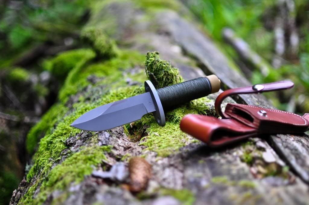

Not so - for example the ROBSON RPW is a one piece construction knife
https://www.google.dk/search?q=holl...a7dBUM:;ZT6NPBBL6EMRCM:&imgrc=bvnWSZNUa7dBUM:
Though you are right in that there are some two piece construction hollow handle knives out there, which are of weak/cheap construction and will undoubtedly easily fail.
Other two piece construction hollow handle knives are of high quality - check out Sam Wilson's knives, Martin knives et al.

Robson RPW
I have one. Very nicely finished. I'm still not sold on the o-ring, at least with a lanyard attached. Very, very solid. Good geometry for casual use, but not great.
