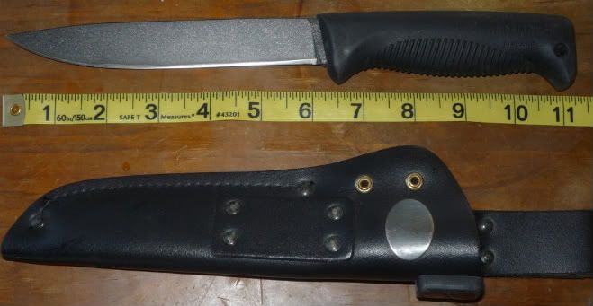

this is a debate for us knife hunters.some people love big knives some like smaller blades..i think using a smaller blade comes with experience.i like my blade slim with a 6" blade..i like to see what you come up with.please post pics..by the way this is my hunting knife i been using for the past five years,here is a pic when i first got it..i have killed more pigs with my old kabar then any other knife.
