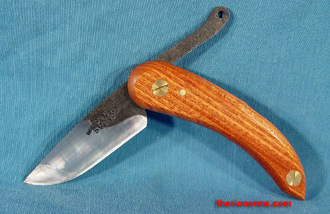

I know this isnt what you were asking about directly, but what about an opinel in a colored handle, or a Svord Peasant or Mini Peasant, they also come in colored handles.
The Svord is what my misses carries and the friction folder is great for gloved use, cold weather is fine, no worries of gunk in the mechanism since they are Incredibly easy to clean.

Problem, in this case, with the Peasant, or any friction folder, is that the thumb, in effect, is the lock.

Well, with the peasant the extended tang comes up kind of in the middle of your palm when you're using it (assuming normal grips). Also, there is a stop pin in there that locks it during "pressing downward" cuts. So I'd be willing to bet even someone with arthritis of/in the thumb wouldn't have a problem using it. I have seen some friction folders with shorter tangs though, where I would be worried about that exact problem (Higonokamis, etc).

Svord Peasant knife might be easier to open for arthritic hands
Yep, with the longer tang it takes the "thumb" out of it, in regards to holding it open. I find that the tang tends to settle from under the pointer to mid palm depending on the hand size.

The Pheasant is really interesting! But where does the "flipper" go when the blade is in the handle? Does it just jut out? That seems awkward. Otherwise, that could be a solution.

Yep, pokes out the front, it isn't that large to be cumbersome, but it can be noticed. When the misses gets home, I will snap a photo of hers, her hand, and a dollar for reference. She is thing, only 4'8" so the knife will look larger compared to get hand, but both will be tiny to the dollar.
