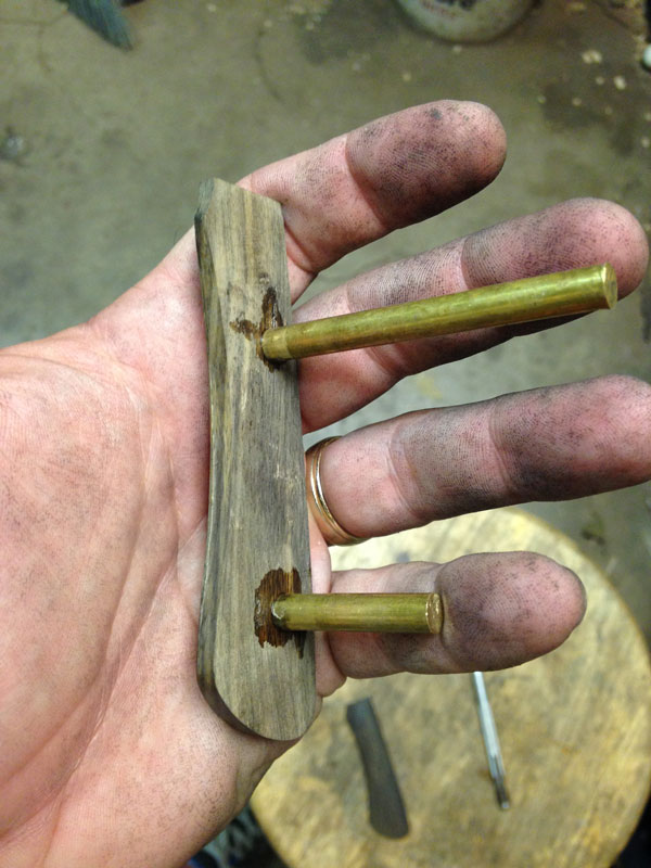

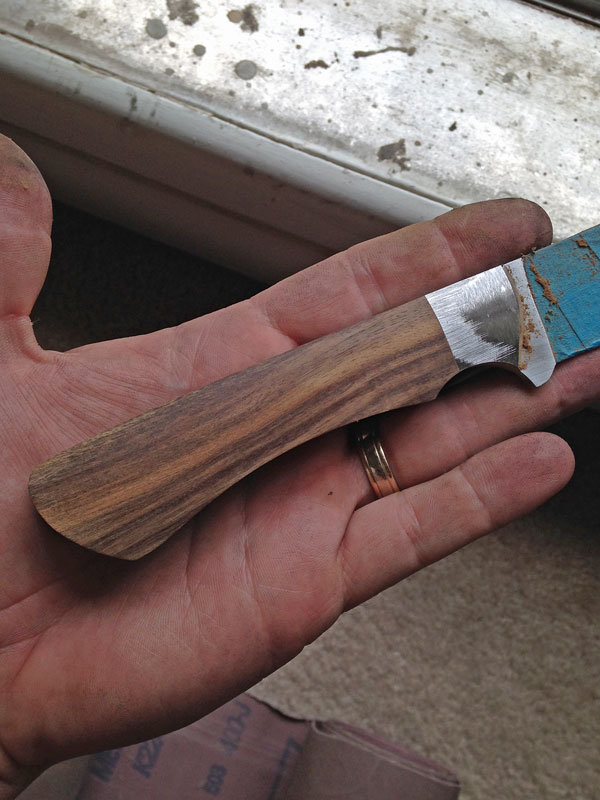

First thing, you have to have the handle pretty much finished before you do the checkering. I used hidden pins to keep everything lined up, and a tiny bit of superglue to hold it all together for shaping and polishing. Here's a pic of the knife after rough shaping, but before I took the bolsters to 1200 grit and the wood to 600. I could have finished the knife entirely, glue up, polish, and all, and then done the checkering, but since this was my first checkering attempt, it seemed to me like there was too much screw up potential. The way I did it this time, if something had gone catastrophically wrong, I could have replaced the scale without having to tear the knife apart.

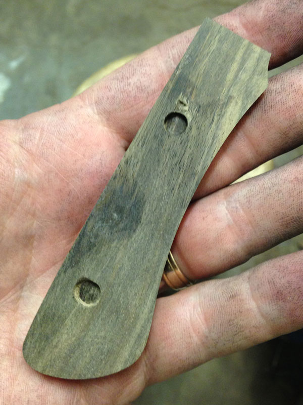

Here's a shot showing the location of the pockets for two 1/4" hidden pins. I had originally set the blade up for a 1/8 mosaic pin and a 1/4 thong hole and had "swiss cheesed" the rest of the tang with 1/4" holes. I used two of the weight holes for the hidden pins.
This worked great! I superglued a couple pieces of longer pin stock into the pin holes, then clamped the pin stock in my vise. Provided a solid hold with no wiggling, and was easily removable afterward.

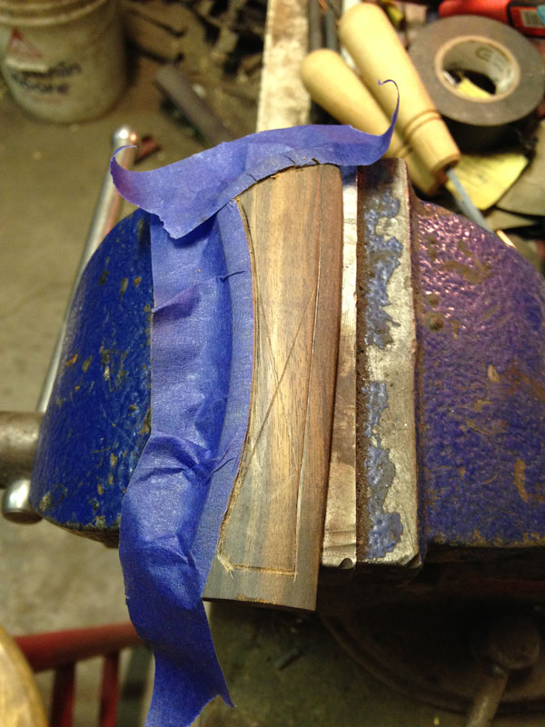

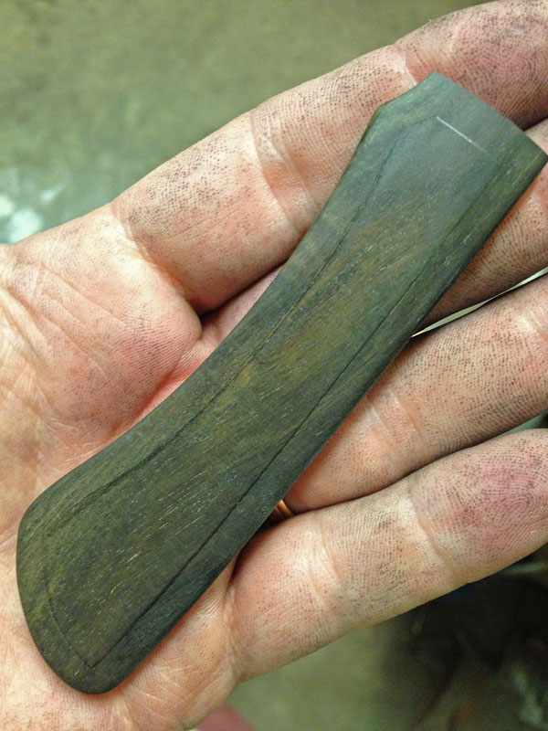

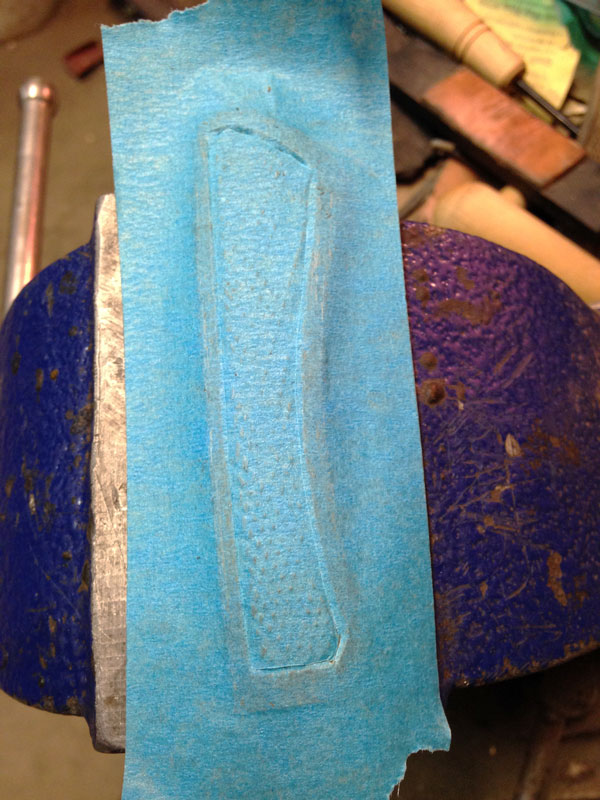

I used a caliper set at .2 inches to scribe a line to set the border of the checkering area. The .2 was arbitrary, just looked about like what I wanted.
This next pic shows how I made the border cuts. It's hard, since I'm a novice, to cut curved layout lines without some kind of guide. I used some masking tape carefully placed along the scribed lines. The thickness of the tape was just enough to guide the cutter to put the lines where I wanted.
Something else I should point out from the picture above... You'll see the first two lines of the pattern laid out. In this case, they were arbitrary at about the angle I wanted. Supposedly 1:3 is an acceptable ratio for the layout, but I just eyeballed it.

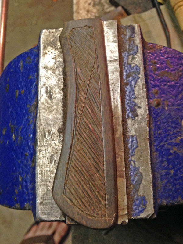

You want to lay out all the lines in one direction before you go back to doing them the other direction. Your master lines from the picture above will be enough to guide you when you change directions. In this case, I'm a novice, and my two-line cutter was dull, so I had a heck of a time getting the lines evenly spaced. As far as checkering goes, this is fairly poor. Several of the youtubes I watched recommended that you lay out all the lines lightly, then deepen them later. Don't try to take it all in one pass. Also, don't cut your border line too deep until the very end. Gives you a little more margin for error on the layout.
Here's what I ended up with on the first side. As a first effort, not terrible. The back half looks OK.

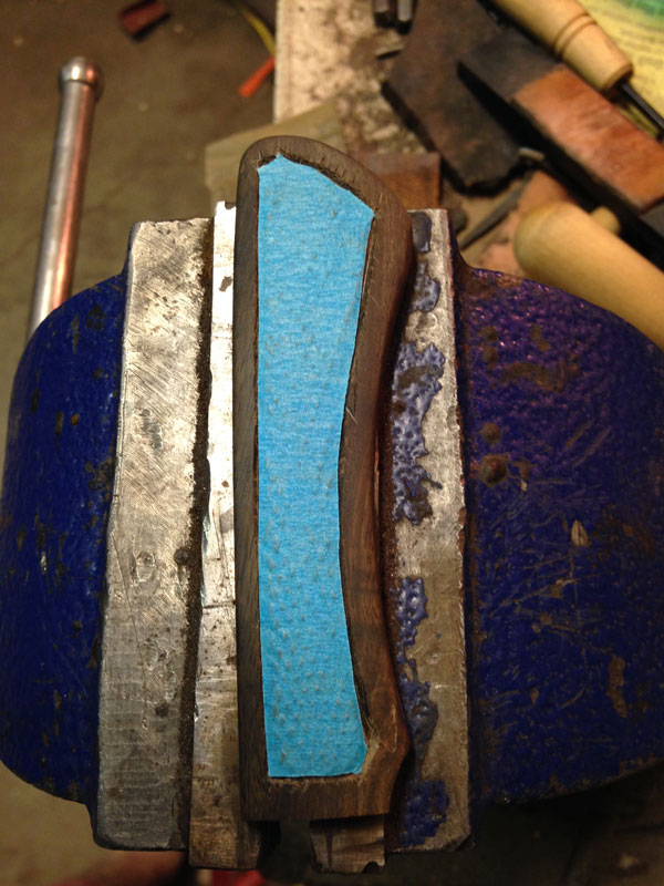

Here's a trick I learned from finishing a gunstock back in the day. You'll invariably have some overruns that generate scratches in your finish outside the checkering border. You'll want to clean them up with sandpaper, but you don't want to sand the tops off of your checkered diamonds. The key is tape and a razor blade. First you put the tape on the handle and rub it in hard. If you have sticky enough tape, you can do it by hand, but I used one of my leather-backed sanding sticks to rub it in.
Alright... once you have the tape applied, use a razor blade (or a knife, we're knifemakers after all) and cut through the tape along your border line. Remove the tape outside, leaving the tape covering your checkering. That way you can sand as necessary without risk to your checkering.

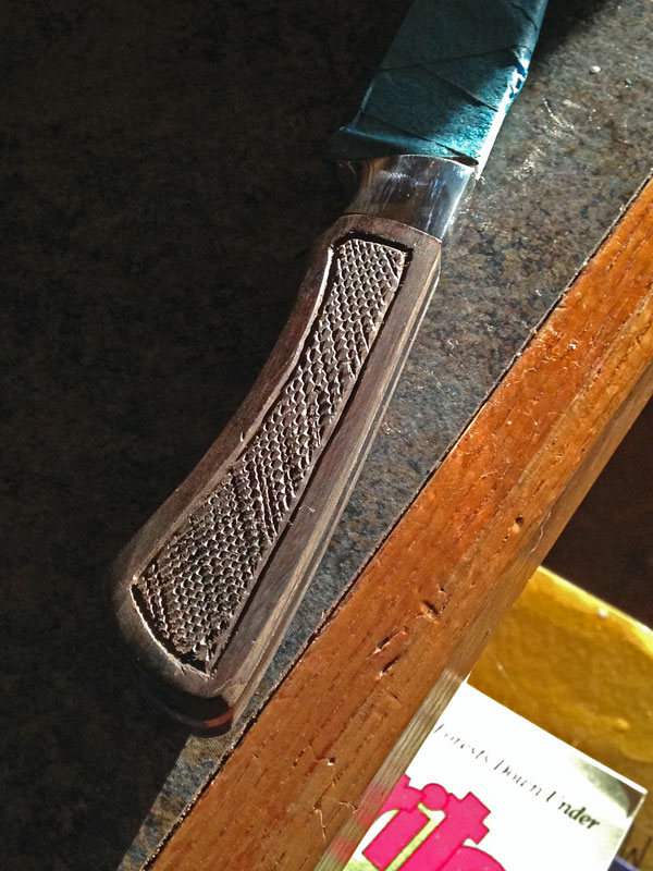

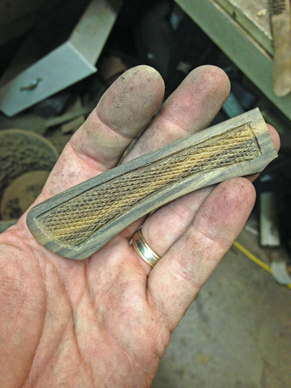

After that, it's just knifemaking. I glued the knife up with the hidden pins in place. Then I re-polished the bolsters to 1200, taped them off, and buffed the bolsters shiny. I didn't want to buff out the handle. One last tip... a toothbrush works well for cleaning out the dust and gunk from the checkered area. Overall, it turned out just OK. Somebody will fall in love with it and take it home, but it won't be anybody who's a connoisseur of checkering.
Here's a shot in some slanted light that really shows the checkering.
Here are a couple of pictures of the finished knife.
Hope somebody learned something. Anybody out there who's got tips for me on how to do the next one better, your input is welcome.

Not bad. Try and make the ridges crisp. They can get flattened easily in final sanding and buffing, so get all shaping and sanding done first if at all possible. When some are flattened and some aren't it looks worn down.
that's a nice knife. The checkering is "rustic" but I like it and I wonder why we don't see checkering more often on knives.

Try to find a two and three line spacer. The two line spacer has one cutting side, and one blank side. After you cut the master line, use the two line spacer to cut the next parallel line. After you have two lines use the three line spacer which has one cutting edge and two blank edges. I've found this makes it much easier to maintain good line spacing. After having all the lines lightly cut in, you can use two and three line cutters to deepen all of them.
Also, If you cut a pattern out of a durable flexible plastic you can trace the outer edge onto both sides of the knife. Lightly cut in the outside line. And when finished cutting in the field, come back and finish cutting the outside line to full depth. This gets rid of some over runs.

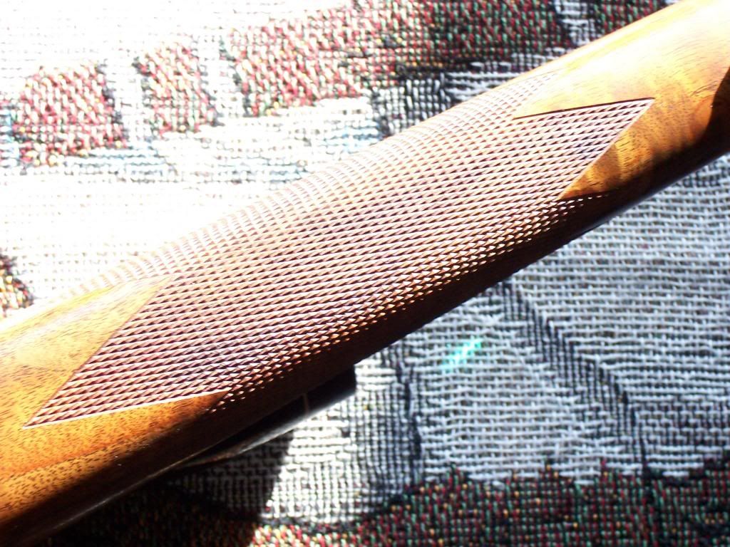

I have used Dembart checkering tools since 1970. Master lines must be cut precisely and followed exactly. I always used a diamond cut to either 2.5 to 1 or 2.75 to 1 length to width ratio to establish my master lines . All my patterns were boarderless with the diamond tops being the same height as the surrounding wood.

Thank you for the kind compliment regarding my work. The top three tools pictured in Jason's post are Dembart checkering tools. My only additions were a Brownell's bent needle file, a thin acrylic straight edge, masking tape, my acrylic diamonds and a precise scale drawing of my pattern.
Measuring and marking the center line of the fore end, the boundries of the patterns must be precise otherwise the work will be lopsided. You must work with good lighting and in a comfortable position. Follow through is important. It cannot be done if you are cramped. Sharp cutters are a requirement for good work otherwise you will slip or tear out diamonds. Patience also helps and never try to checker when you are tired or in a rush to finish...disaster usually follows.
