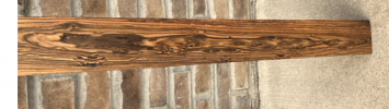

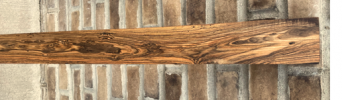

I was reminded of this thread today..... Whenever I happen to be going by my local Woodcraft store I drop in and see if anything new is in. I came across this piece of Bocote. Lots of nice alternating contrasting grain. Not thick enough to use for Wa handles, but easily thick enough to resaw pieces to get plenty of bookmatched scales. I wonder how that central strip with "eyes" would look if cut into scales with focus on that type of figure?? (I need to get it down into the shop and check the moisture level....)
