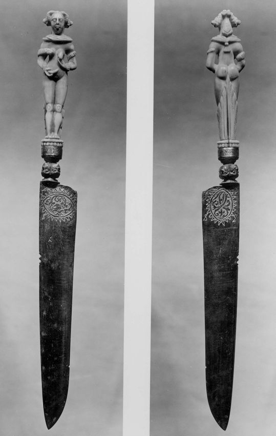

The Renaissance was a period between 1300AD and 1600AD. I am no historian by any means so take that for what it’s worth. but that time period probably had some of the finest crafted knives of all history. I am excluding the modern day high end custom stuff we see today. This was a time when “ART” was in so to speak. Style was everything and said a lot about who you are and your position. Hell even kitchen knives where fancy. So with that being said, it’s rather inaccurate to say

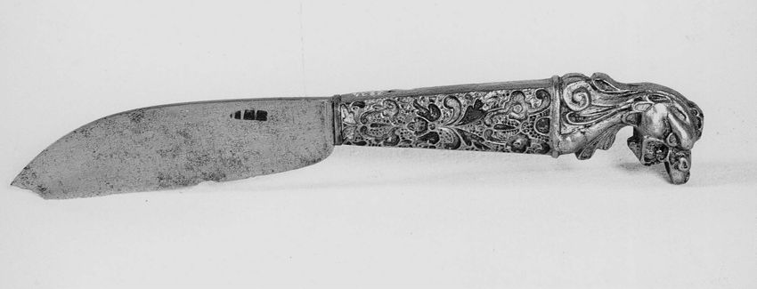

Here are a few examples of the craftsmanship of that era.
16th century
15-16th century
1300-1350
15th century
15th century
16th century
16th century
16th century
1600,ish
Saw steel was/is usually L6, if I recall correctly. Very tough stuff. Also, most people I see that are in renaissance fairs are dressed in the pre Renaissance style. Not like Florentine merchants at all.
Hmmm, I'm with JT. If you want to do a knife for a ren faire then by all means. But there is a world of difference between period correct, and merely "rustic." Some truly amazing craftsmanship came out of middle ages and renaissance Europe...

Most people were peasants at that time, and wouldn’t be able to afford in 20 lifetimes what one of those beautiful knives would have cost.
Jut a piece of advice:
Calling something partly finished or roughly made "rustic" or "renaissance" isn't a good idea. Rustic doesn't mean unfinished, it means unadorned. As said, the renaissance was anything but rustic.
Rustic knives should be well made, well shaped, and the handle properly shaped and finished. They don't need guards, or embellishment, but should be sanded and finished as any other knife.

I'm actually not talking about some masterwork piece to be seen in some museum. I'm saying that craftsmen are craftsmen, and saying something is going to be finished poorly just because it wasn't made in modern times is doing a great disservice to our forefathers within the craft. There are any number of very simple day-to-day knives from the period out there that exhibit a perfectly acceptable level of quality.

You are correct about the "Renaissance" period and craftsmanship. However most renaissance festivals that i know of mix everything from the 1000ds up to the 1700ds, and have a mix of everything from ancient styles all the way to fancy flashy stuff. The guy I made it for wanted ancient style so thats what I tried to base it off of.
Kinda something a farmer or traveler of the 1100ds or there about would have used.
