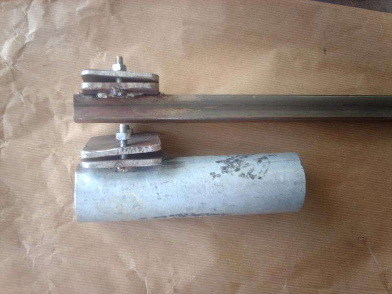

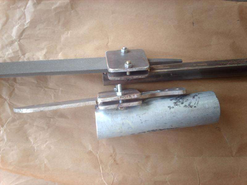

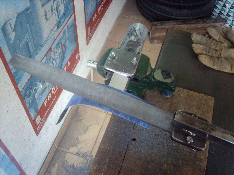

Just a quick advice. Seems like you are lacking a belt sander... just like me. I built myself a rig like this (ala GreenPete), which helps a lot in keeping the right angle while cutting out the bevels. With that shitload of equipment you have there I am sure you can make one for yourself in no time!
The square tube is about 3 feet long.
The square tube lies slides over a perpendicular piece of 4x4 I clamped to my working table. That way the angle of the file and the blade is always the same.
I learnt this the hard way. Once you are done cutting one side of the bevel with the file DON'T REMOVE THE BLADE FROM THE RIG!!! Cut a few strips of 80grit sandpaper and put it between the file and the bevel. This way you will be able to polish most of the scratches right away. It takes FOREVER if you try to do it by hand later on.
One more tip. Once you are happy with one bevel (it takes some tweaking with the bench vice untill you get the correct angle) DON'T REMOVE THE RIG FROM THE VICE!!! Just loosen the two screws on top, slide off the blade and slide it in from the other side. This way you will end up with the very same angle on both bevels.
I only use two HUGE files to cut my bevels, coarse and fine. And of course I don't remove all the steel with the files... I cheat as much as I can! I file a bit, check for scratches, use the angle grinder, file a bit more, check again the scratches, grind more, etc... Be gentle with the angle grinder when you are about to finish so you don't screw up at the end.

If you don't want to mess arround with soldering anything, it is ok, but try to use a bolted on construction. Better than C clamps and less bulky. I will also suggest you using square tube instead of flat bar. When filing we (at least I) tend to lean into the file a lot and you can get the flat bar to flex easily... resulting in a not so flat bevel.
