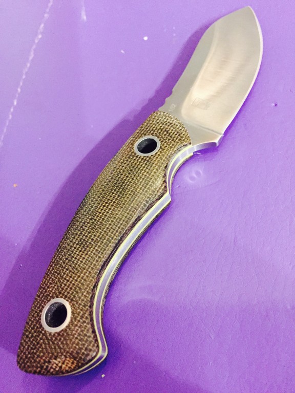

I just discovered that one of my little fixed blades has a tang that is magnetic. Blade seems to be neutral. Is this even possible? Just half of the steel is magnetic? And why!
It depends on the knife. If the knife has a lanyard hole and a steel tube inserted that could be it. There could be hidden pins under the handles. As for magnetism on just part of the blade? Im not entirely sure what is possible but I have had crazier stuff happen.
Did you put the knife against a magnet for a bit at some point? I tend to keep my knives on a magnetic strip mounted to the wall, and they are magnetic after being stored there.
The blades on my Buck knives are magnetic. I was told they get magnetized during the manufacturing process due to the blade coming in contact with magnets along the way.
Rub two or three times with strong magnet in one direction. Then, rub with strong magnet once, maybe twice, in the other direction. That kills the magnetism of the blade.
Magger/Demagger made by Master Magnetics, PN 07524, About $4 at your local hardware store. Will handle about a 1 inch blade. Plastic coated, won't scratch your steel
