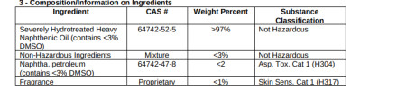

It's mostly mineral based oil, but does not have the purity of food grade mineral oil. Even when they hydro treat it, some unsaturated sites remain on the oil molecules. Those sites can degrade. And it has solvents and fragrance added to it.
Here's what the SDS says:
edited to add:
DMSO = DiMethyl SulfOxide. It's a solvent and relatively toxic. Likely a residue of the oil processing.
Re: gummy-
The actual oil in 3 in One and 90% of the other oils is mineral oil.
Specifically it's a naphthenic mineral oil fraction as Knarfeng cited. The "non-hazardous ingredients" is supposedly citronella oil, which--contrary to mineral oil--is an oxidizing oil and likely the cause of the varnish. Mineral oils of certain grades can sometimes degrade and plasticize but it's usually in exposure to heat where the hydrocarbon chains break down into higher fractions of hydrocarbon compounds that are more reactive and can recombine into longer chains that are waxy or polymeric, but knives are unlikely to experience those conditions. The varnish formed on 3-in-1 oil treated surfaces I've seen was similarly not likely to have been the result of those interactions and so it seems most likely to me that the natural plant-derived citronella oil is the likely culprit, especially since it's known to be an oxidizing oil.
