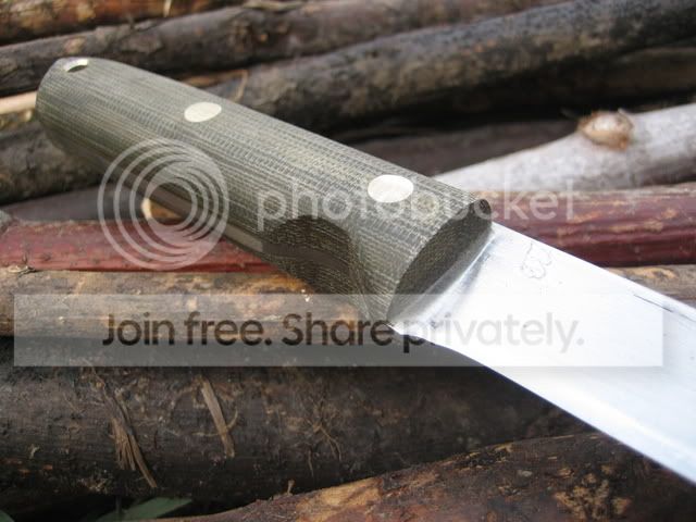

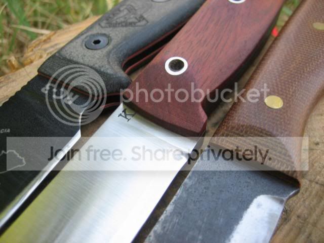

I wanted to share a very simple modification to improve comfort while executing certain Bushcrafting grips. I am not going to get into all the possible grips for Bushcrafting, but mainly focus on the chest lever grip or side grip.
Chest Lever Grip-This makes for a power cut but can also be used for fine work. The advantage of this kind of hand position, is that you can have it at chest level right under your view for powerful yet very controlled cuts.
Notice the position of my thumb is half on the scales and half on the blade.
Under view.

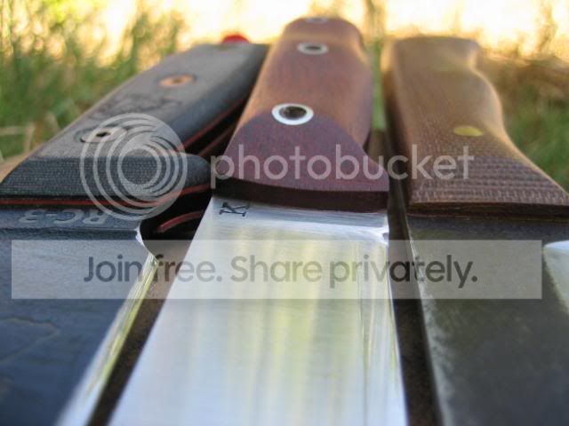

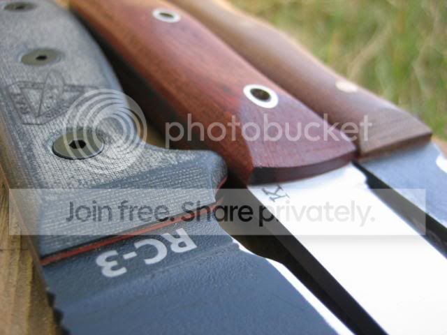

A few knives that come standard with this thumb notch are:Muskratman Puuko/Bushcrafter, RAT RC-3, RC-4, and JK Handmade Knives Bushcrafter. I think the JK has the best all around handle that really fills the hand and has the best version of the thumb notch/ramp. Brian Andrews makes a mean Scandi knife with this same feature, but he isn't taking orders yet:mad:.

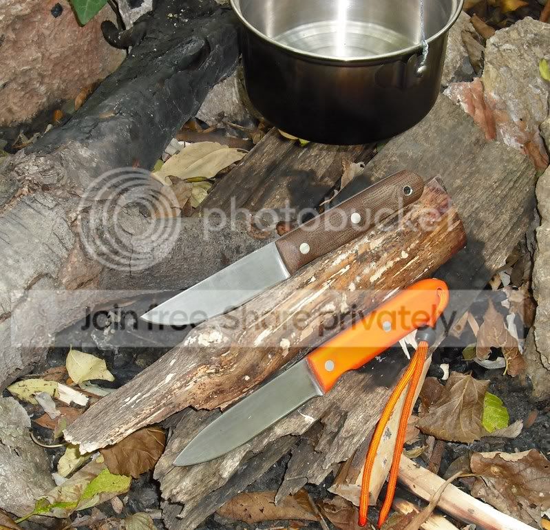

Quite possibly my most used knife at home and abroad, is the RC-3! RAT really has all aspects of outdoor use covered with the RC-3/RC-4.
I decided to implement this mod on a few of my custom knives that I use the most. My JK Hiker and Breeden Kat were used in the tropics extensively, and not just by me.

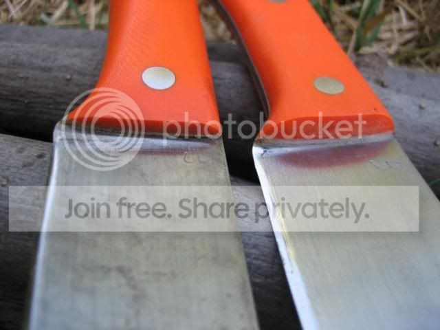

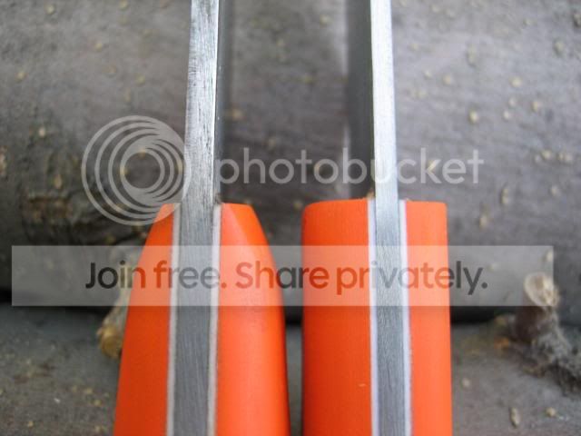

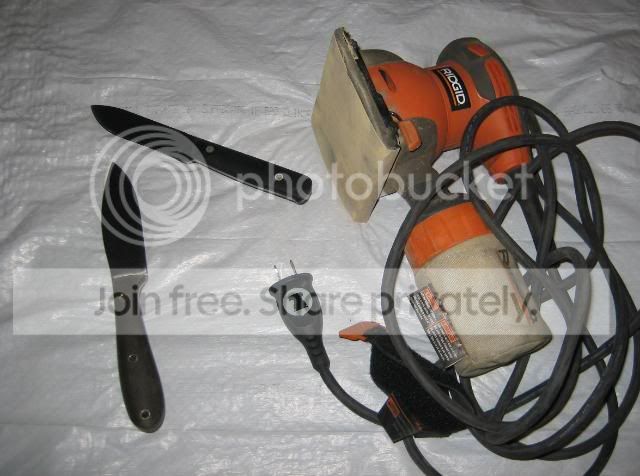

It starts with a simple hand sander and 50 Grit sandpaper. You can also tape the blade to keep it from getting scratched and for safety reasons.

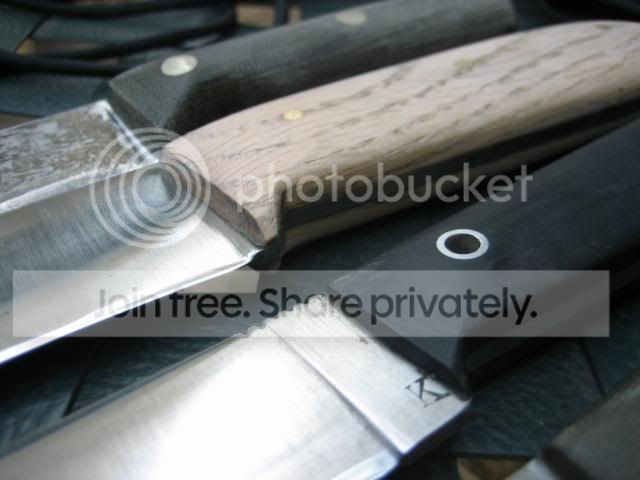

A few before and after pictures of the Breeden C.U.B. (I have a few of these)
You can see the difference. The knife on the right has that sharp corner that can hurt after 1 minute of use.

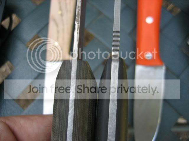

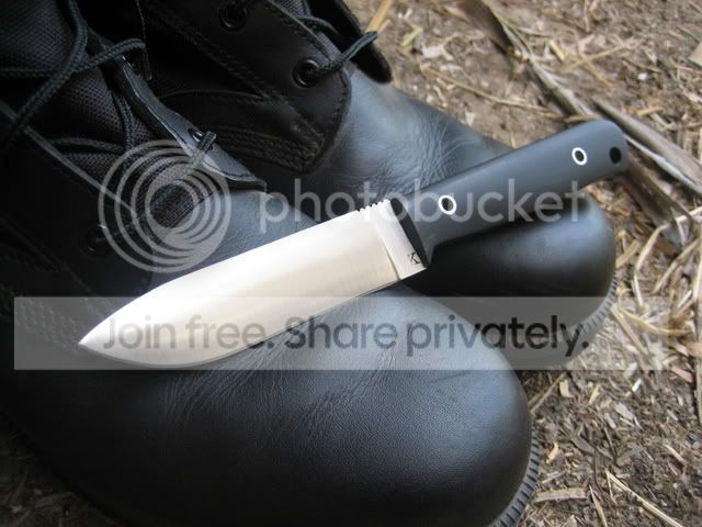

Breeden Kat and JK Tactical Hiker before.
After

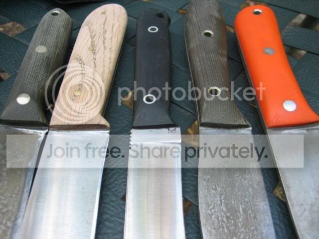

Kat-Hiker

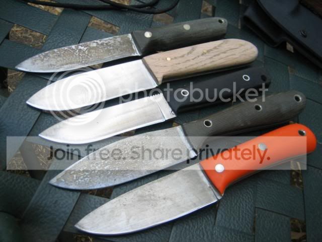

Breeden Kat, JK Kephart, JK T-Hiker, Breeden Pathfinder, C.U.B.

Hey is the CUBs scales differant thickness or is it just the pic?
Sweet Ruben!!!! I like the mod!
Damn you are good J! The left C.U.B. is done with 3/8-inch thick scales but it made the knife real heavy. The 1/4-inch scales are just perfect. I don't know what Jeff H got on his. I think JK is using 3/8-inch scales on his Bush, but the wood is much lighter so he really got the balance right.

Are you using just the 50 grit paper, or going through the grits to progressively finer? Would it make a difference?
I used 50 grit to sand down the sharp corner, then move to 150 to keep it grippy. For G-10 that may be too slick, but it really makes it look evan! I used 220 as final finish on a C.U.B. and JK Hiker, that worked out pretty good.
