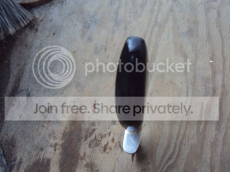

Some of you probably remember my 1st thought with this knife and it was a disaster in the handle dept. Just for kicks here is an old pic of the disaster.

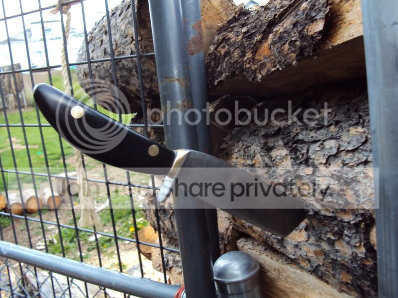

Here is the new handle, shaped for a right handed person or at least what feels comfortable for this right handed person.
Let me know what you think. It is not perfect but better than the 3rd knife that is certain. It is right at 12" long, 1.75" deep and touch over an 1/8" thick. 660 layers of 01 and 1095.

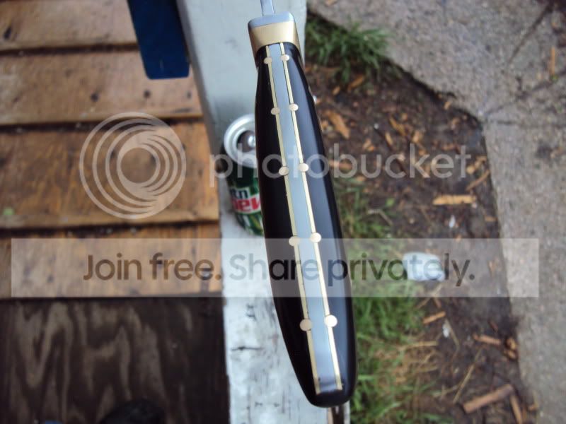

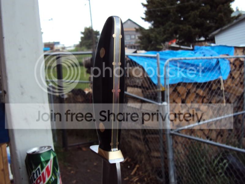

A view of the shape of the handle.

Very unusual style. Not sure it appeals to me but that's OK. I like what you did with the pins/liners along the spine- pretty cool. I'm surprised you are making damascus for your first knives, it will come out looking a lot cleaner if you work on your grinding skills and get a smooth sanded finish of 600 or more to etch from. Detail shots of the handle and the transition from handle to blade on the spine at the guard look actually pretty nice, you pulled that off- I did notice what looks like a mean platen gouge on the reverse side close to the guard. A little more practice and that stuff won't happen anymore. Keep it up, looks promising.

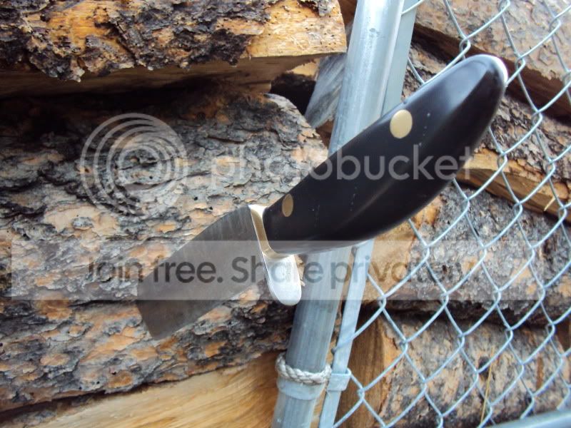

Cut down some trees in the back yard about a year ago and stacked them up. Decided today to clean it up. Took this knife and hacked branches off, then hacked them into smaller pieces. Took a few hours to do and after all that it still cuts paper. It chops real nice which was the intention of the knife. The shape of the handle just works out perfect. I am now real happy that I know it can take some serious abuse and stay sharp.
Well if the knife does what you intended it to do,thats satisfaction,in my book,many plp have many opinions,your design is like no other and thats a good thing,use your imagination hard telling what the next one will turn out like! Skill comes from hands on hrs in the shop,all you can do is try,try again till you get there,and your definatly getting there!good job buddy,now chop the hell outta something,post some more pics!

Now, on to serious comments, show me some close-ups of the corian where it was glued, please. Is there a line? Did you use the piece I glued or did you glue the other pieces together? I love the pins in the handle the first time, and I still love them in the corian. It kinda reminds me of something a sailor would use on a ship.
What did you think of working with corian? My wife loves it and wants it on the handle of her kitchen knife, but I can't stand working with it. I'm thinking to melt some down and make a poured handle if I do.
There is a real small line but it is not bad at all. I did use the piece you glued, it stayed together right until the very end. I roughed up the edges, epoxied it with black epoxy and then knocked the ends of the 3/8" brass with a hammer. That handle will never come apart I do not think.

As for working with it, it is not too bad, kinda sucks with a finer belt. But with the respirator and some safety glasses it went pretty smoothly. I think it would mill well at a higher speed. I drilled the middle out so there was just real small areas that needed removed. Then I milled it really really slow as I did it with a drill not a mill. I did not want to fubar the drill, for over a 100 years old it did pretty well for as slow as it turns.
