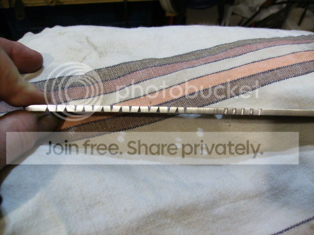

I believe the knife is ready but i have a couple questions prior to heat treat. Should the knife be sanded down to 400 and then buffed shinny . ????? I did a rough sharpen on the edge and sanded out any deep scratches its slightly sharp but i can feel a small burr that developed but i could buff that up in a heart beat or does that wait til im in the step just before i glue on the handle /fingergaurd . I did sand a little at 240 and then took a scotch brite belt and buffed it up with that . I am just a little confused as to the steps with out alot more reading. thanks kellyw
here are a couple pictures
I usually do mine to 220 grit, I sand them on the 6"x48" sander, making sure to get them flat, both sides. But I have sen guys do 120, 80, and on up to 400. I have one friend who gets the knife ready to ship, and then heat treats it. Then after HT, he cleans it up and sends it out.
A few ideas....hope they help.
Well, everyone has their own level of finished ,but I would not consider that knife ready for HT.
1) The grind could be moved farther up the flats.
2) There doesn't appear to be any distal taper on the blade.
3) The flats are still very rough. They should be as smooth as the bevels.
4) You never want the edge sharpened (even a little bit) before HT. The edge should be about .040" thick pre-HT. The blade may well crack or warp with a fully sharpened edge (as well as have too much de-carb in the edge).
5) Plunge line needs to be cleaned up.
6) Do not polish a blade before HT. Just sand to 220-400. The blade should look about the way you want the finished knife to look, just not polished or sharpened. Removing any deep scratches or defects after HT will be much harder.
The overall look of the blade is nice. Just sand a little more and tidy it up before HT. Dull the edge back to at least .020.
Stacy
