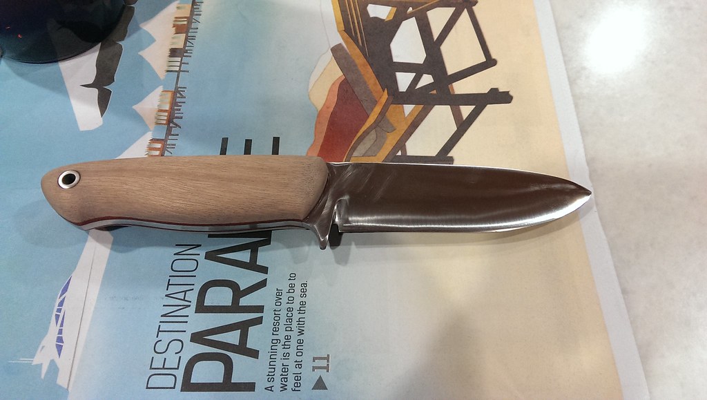

Ok so after nearly a year since I started on my journey to make my own knife I am now happy to report that I am in the final stages of finishing the knife! whoopie! I spent a lot of time refining the design through multiple prototyping just to get the "right" handle. I went through 20 odd versions before I settled on this one that feels right to me. This has been a really really slow project for me since I only have a couple of days a month on weekends to actually work on the knife due to my job schedule and other weekend activities.
The knife is fully functional but is really just a proof of concept for me before I start using Elmax steel. Currently I am still in the process of treating the handle with tung oil so it will be a good 2 more weeks before I finish with it's 3rd full strength coat and fully cures. Some stats to the knife:
Overall length: 233mm
Blade length: 111mm
Blade thickness: 4mm
Handle length: 92mm (at the belly)
Grind: Drop point half height convex at an estimated 18 deg.
Blade Material: D2 at 60.5 HRC with cyro. Low temperature temper
Handle: Meranti (a local light hardwood) finished with pure tung oil, red vulcanised fiber as liner
Notes: The blade is finished to 600 grit - I just didnt like mirror finish. There is one 8mm OD tube as lanyard hole plus another 2 hidden pins.
I have learned a lot from making this knife, and obviously this knife itself is not perfect and has quite a lot of flaw. Two of the most obvious now is 1. I screwed up when trying to refine the plunge line by over grinding the area. 2. I should have properly tape up the blade before sanding the handle to prevent scratches to the nicely polished body.
My photography skills lies somewhere else but I promise more pictures once the knife is fully oiled.

Good first knife.
....with one big thing to never do again.....It needs rivets in the handle. The epoxy WILL fail in time and the handle WILL lift up at the front.
Bladsmth,
Do you think hidden pins could work if they're deep and press-fit? Granted this probably wouldn't hold up in natural wood that can swell and shrink, but stabalized woods and synthetics (G10, micarta) should be stable enough to hold tension. I would think that a set-up like that combined with a high quality epoxy would be at least as strong as full non-peened pins with epoxy.
Hidden pins will work if properly made , but my take on them is ....Why hide the pins?
If I made a hidden pin, I would not make it a press fit. I would make the pin have grooves or threads, undercut the hole with some room, and use structural grade epoxy.

Good first knife.
Thanks for the note Stacy, I will see how the pins hold up against testing later. I based my design on the a couple of kitchen knives I have that uses wooden handles, no epoxy and only two pins... probably peened. It sees daily use in wet and dry conditions including light bone chopping (cheap knife so we dont really care) and still sturdy as ever.
Do you think if I used highly oily wood like cocobolo will prevent the wood from shrinking/expanding as much?
Wood expands and shrinks. Oily woods - rosewood, cocobolo, African blackwood, desert ironwood,etc. - expand and contract less. Stabilized wood also has much less movement. Oily woods need strong fasteners, like Corby bolts, as they don't bond to the glue as well as other woods.
I know I seem like a salesman for Corby bolts, but there is no stronger method of attaching the handles on kitchen knives. Once you understand the installation, and learn the basic tricks, installation is nearly as easy as pins. I have had scales pop up off peened rivets on chef's knives, warp and lift up on fillet handles with seven 1/8" pins, and found gaps where the scales have pulled away from the blade at the ricasso on kitchen knives....but I never had a handle failure with a handle installed with Corby bolts.
