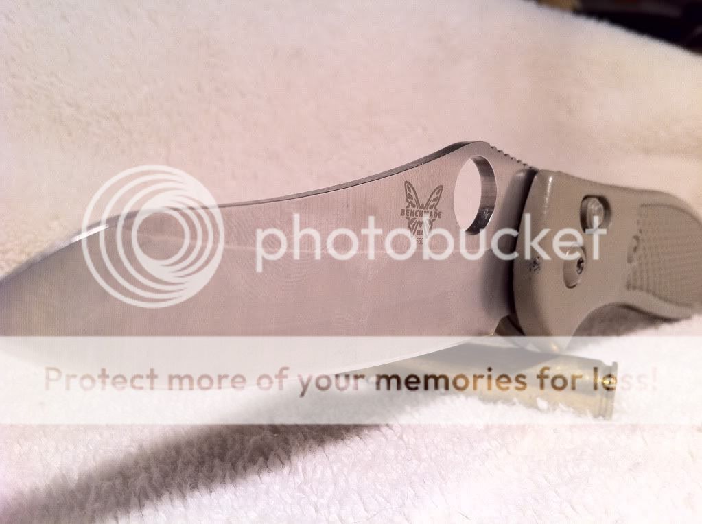

The handles on this Griptillian were black. I Duracoated them Magpul FDE several years ago and it shows absolutely no wear. I also have a few pistols that I Duracoated, it is really durable and you can do it at home for around $30. The black on the end of the handle is from sharpening stones gone awry.
