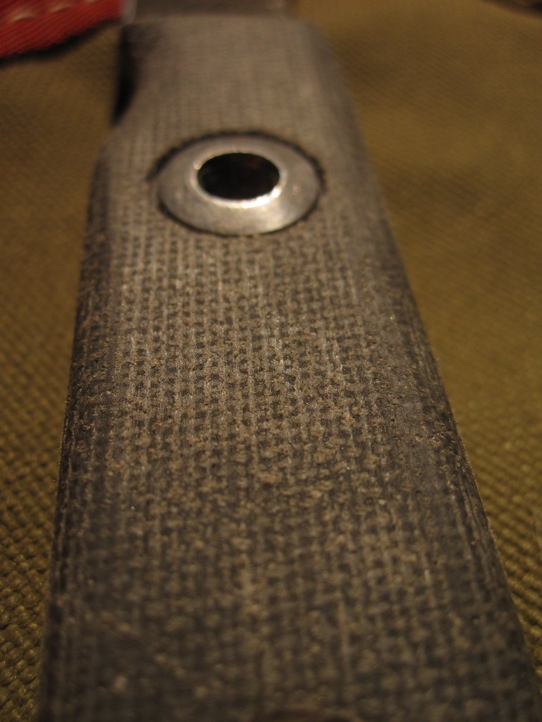

Give TeroTuff handle material a look. It is kind of like Micarta but with a very slight rubbery feel to it. I have used it on a few knives and I liked the way it worked ( worked as in the way it shaped and sanded) . Here is a pic of one of the handles that I used the grey TeroTuff on.
EDIT to add Yes handle shape has a huge amount to do with grip. Even more than material IMO. Using the two together is the key to achieving an outstanding and comfortable grip.
Canvas Micarta or any of the "xxxx-Tuff" materials work well. Just sand to 400 grit and rub hard with a cotton cloth. I use a lot of black canvas Micarta on kitchen knives.
