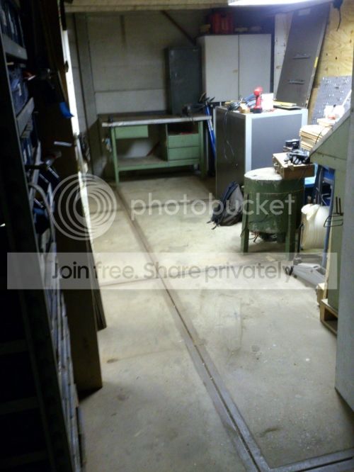

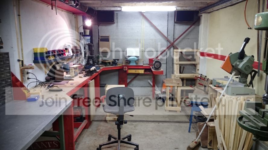

My name is Dennis - 22 years old, from the Netherlands - and about year ago I decided to make knives. So all I needed was a shop. 15 months later, and still no single knife build :) Having fun learning stuff, and things!
First step was to aquire a space close and cheap enough.
After a few weeks of cleaning (long story):
Bulding some walls to stay warm in winter, and painting them:

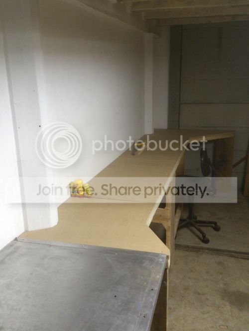

Building a workbench:

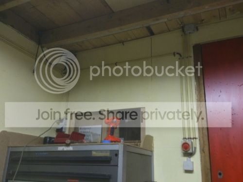

Some wiring:
And after about a year:

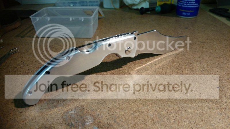

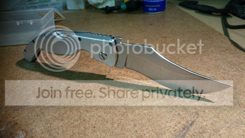

So after all this time, I wanted to do something knife related, therefore I modified my Cold Steel Spartan using the basic tools I had:

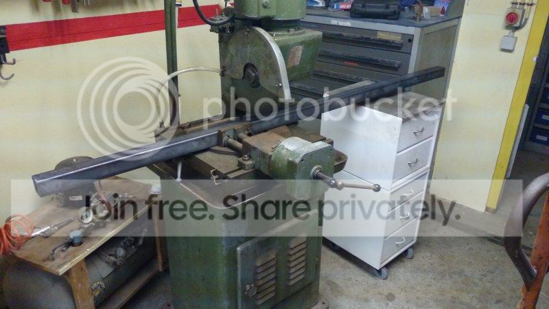

First of all, I bought the steel I didn't already have. Some square tubing, flat stock etc. After measuring I cut all the different parts with the saw in the picture below. I had to replace the wiring partly because the insulation had been destroyed. If I wouldn't have been able to fix this, I would have used my angle grinder but this way is easy to make sure it is square.

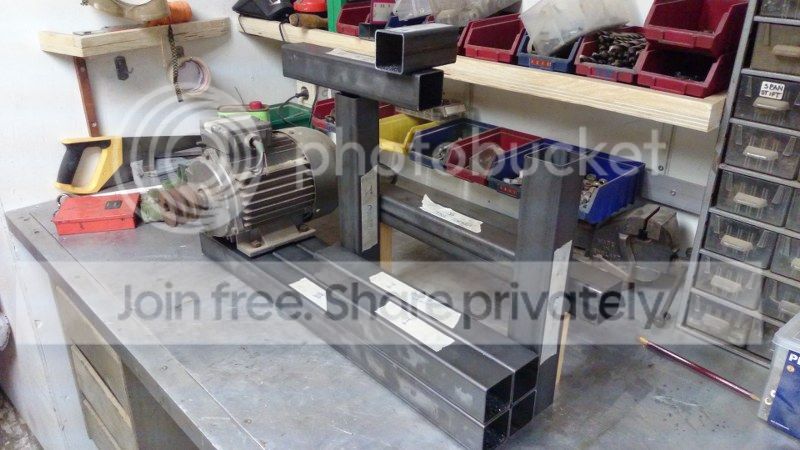

Then I piled them together, along with some labels to ensure I don't weld them together incorrectly. I found and tested the motor a few months earlier, which was buried under a layer of car parts. It's 3-phase running on 400V with an output of 1.1kW.

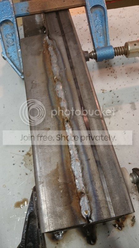

I had done some welding before, but it was a long time ago and someone else knew how to operate the welder. This time it was just me but with a piece of scrapmetal to test the settings and some patience I managed to do some satisfactory welding. If you're doing this for the first time like I did, I recommend to go easy on the buttons. Turning knobs just a little bit made huge differences. (I use a MIG welder)

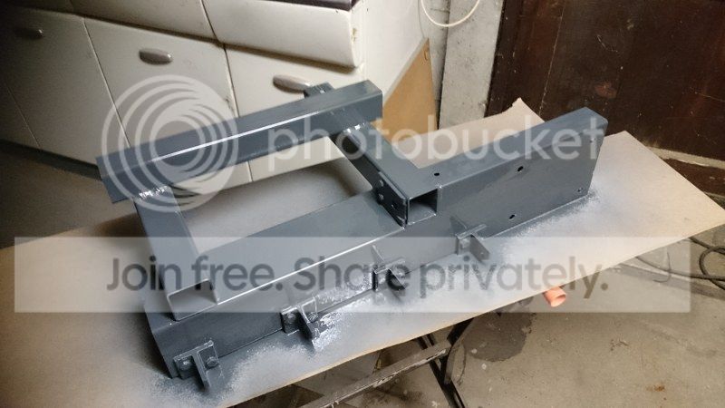

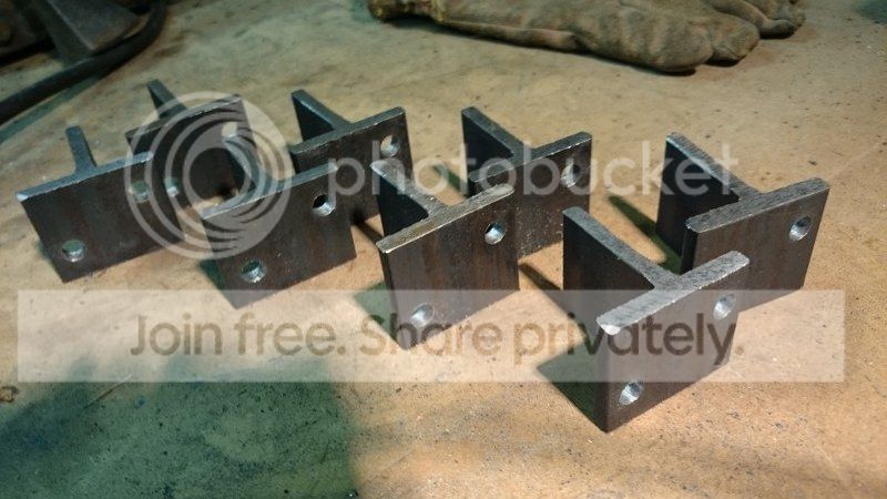

One big mistake I made was welding first, and drilling later. Luckily I have a large drill press so my whole construction could fit underneath.
Then, using the angle grinder I ground some of my welds flat.

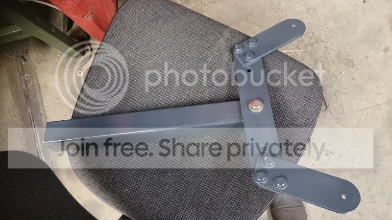

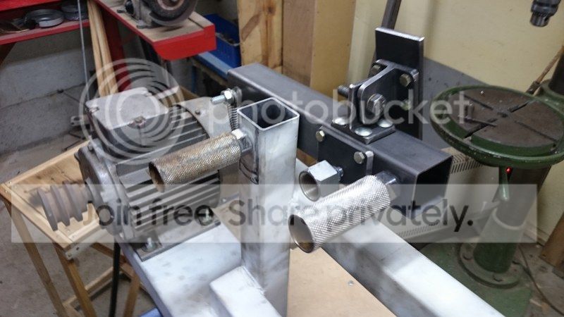

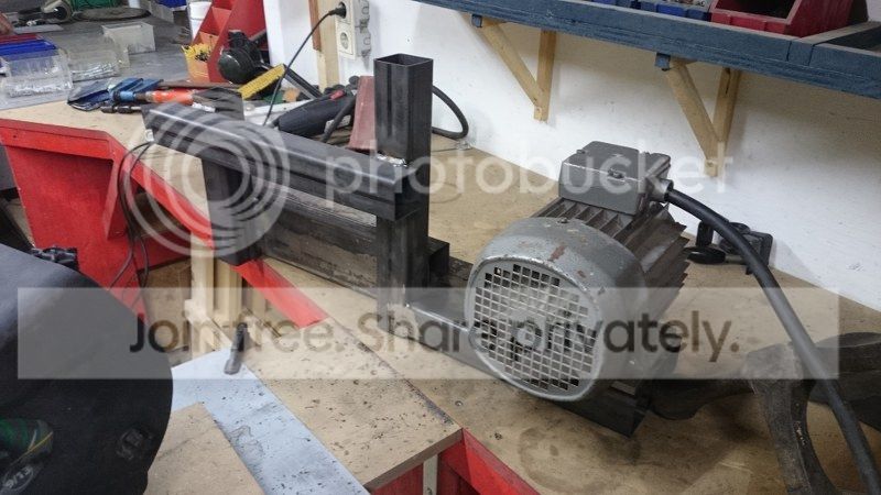

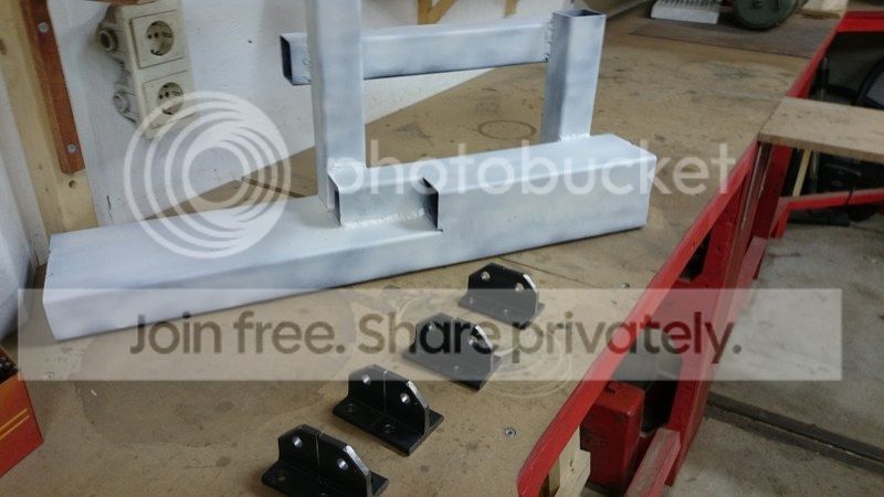

I wanted my grinder to be able to flip 90 degrees, this is the reason why the motor is located on the grinder itself, and why I built these:
And for some reason, I already painted the frame (primer)..

Its always cool seeing how things are done in other countries. With that being said, the 2 knobs on your welder are voltage and wire feed speed. Voltage spreads the puddle (bead) out. It looks like you could use a little tiny bit more voltage. Usually a good place to start for both settings is at about 10%. So if you use 19.5 volts, start your wire speed at about 195 I.P.M. then you can fine tune from there.
Thanks for the tips, I will have a look at which is which :)

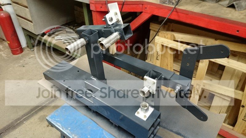

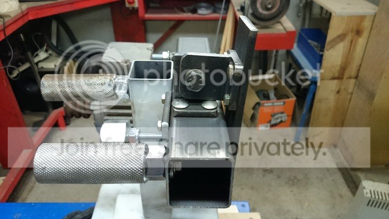

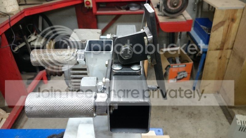

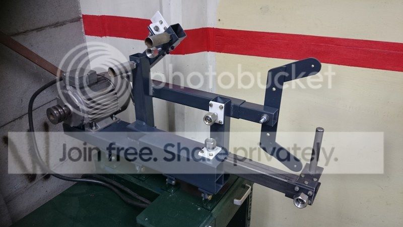

The tension and tracking adjustment assembly
Spray painting:
Then I build a slack belt tool arm, just because this was the simplest and cheapest of them all.

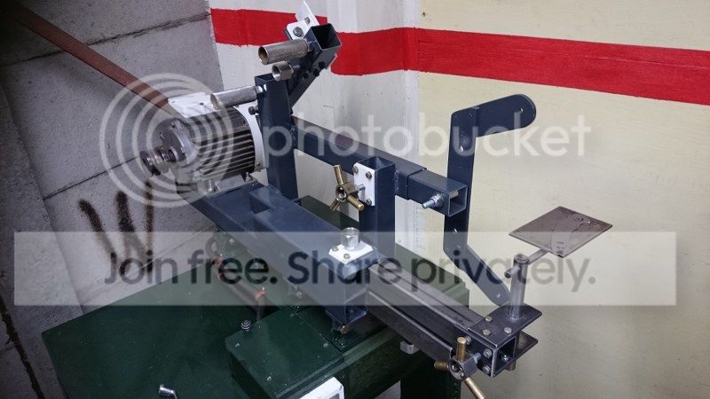

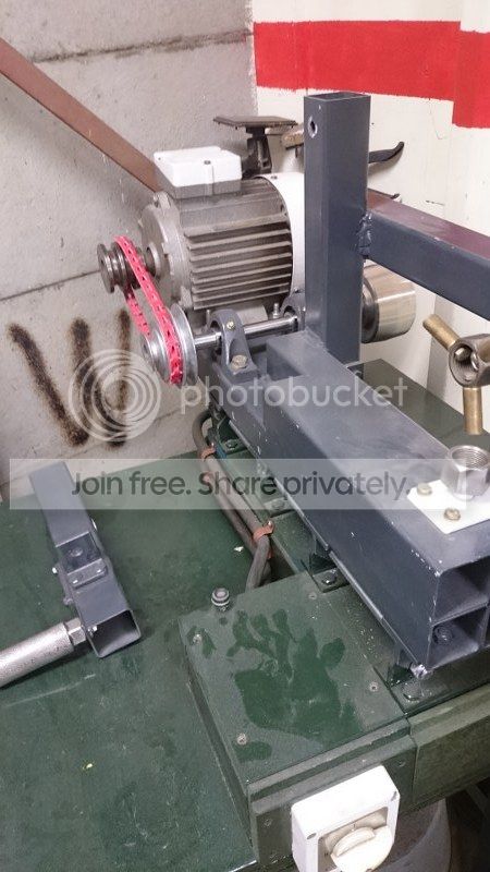

is the motor on backwards in the last pic? or do you plan on running step pulleys from the opposite side? tilting is nice, but that ones going to be heavy. nice use of bicycle pegs btw.

Building a workrest
This workrest is also able to rotate 90 degrees for when you flip the grinder.
Just like you said, the step pulleys on the motor still need to be replaced but this works for now. And yes, it's kind of heavy but I don't really mind the weight, and it has a lock when it's up straight.

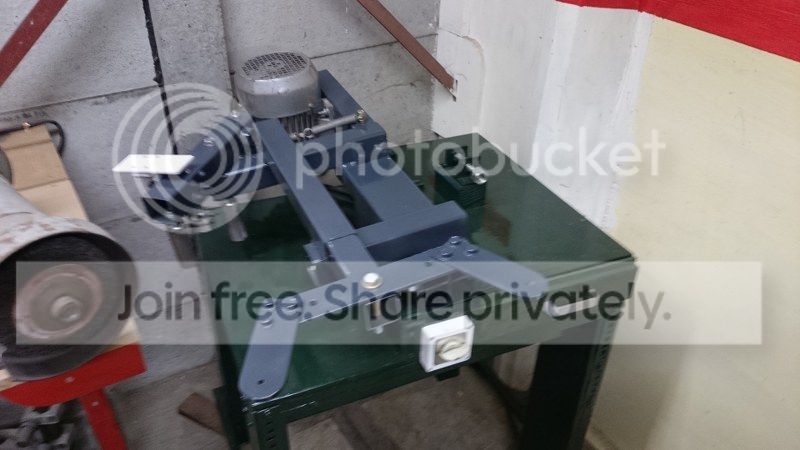

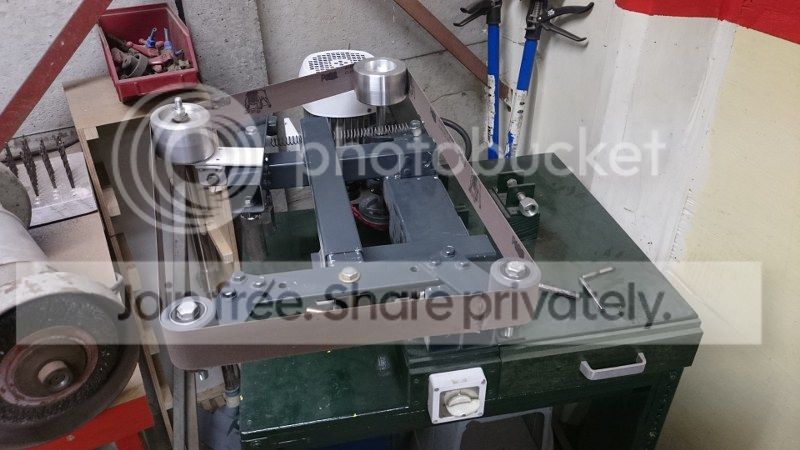

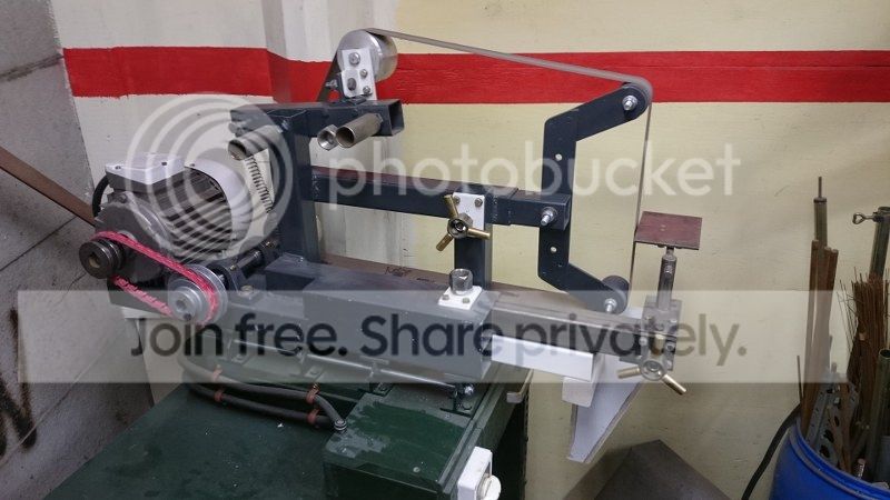

So this is what it looks like right now. I still need to build all the other attachments. I also want to install a switch to reverse the direction of rotation of the motor. As well as a pneumatically operated tension arm, as soon as the compressor is fixed (It hasn't run in at least 5 years)
The belt that's on there is one I made myself, just to check if it fitted. It's 2000x50mm but I can easily fit 2500x50 belts on there.
The linked v-belt is very good by the way!

Cool thread. I think that you will want to plan on making a flat platen for grinding. A slack belt is useful in some situations, but bevels are done primarily with a flat platen or a wheel.
