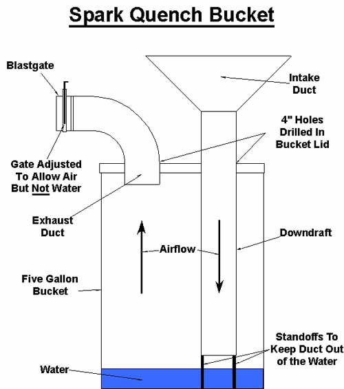

So after I posted my first thread several people commented on my Dust collector setup. The way I had it configured was a fire hazard! Yikes!
Shawn Hatcher helped me the most. He gave me some plans on how to setup a Spark arrestor/quench bucket. This was my attempt http://youtu.be/BtpchjdtxUI . Let me know what you guys think :)
Thanks!
//Eddie
I think you are going to melt the plastic hose and fittings before the bucket. The reducer going into the bucket will accumulate dust and will eventually catch fire.
Place the bucket directly below the grinder and use sheet metal ducting straight down into the bucket. The end of the duct should be about 1" above the water. When you look down into the duct you can see the water in the bucket. Adjust the blast gate until you see the small ripples on the surface of the water. Frequently check the level of the water in the bucket. Grinding for a few hours on a hot day will evaporate the water.
I would move your grinder so the grinding wheel & belt is not above the bench.
Chuck
I agree with Chuck. I realize you have put time and money into this project and hate to tell you it won't work but with the risk of fire, I feel the need to give my two cents. Shawn's diagram is spot on... but I think you have applied it improperly. Research what Chuck has said about reducers in the intake line, plastic fittings and configuring your grinder to have clearance under the belt. Having a bunch of folks throw advice at you can be frustrating when you just want to get grinding... but the dangers that have been mentioned are real. The positive side is that you are way ahead of the game just for thinking about dust treatment.:thumbup:
I found that diagram online and saved it to my desktop for future reference. Unfortunately I don't recall where I found it, otherwise I'd credit the person who took the time to share it. I made mine a bit different than that diagram, but the overall concept is the same. I use 4" PVC and arrange it such that it's a straight shot from the dust collector to the spark bucket.

Right principle but wrong materials... IE Use correct sized metal for the input like Chuck said. PolyVinylCloride = toxic gas/fire when ignited
You will find even with metal fittings the risk of metal dust particles clumping up = metal fire when enough sparks hit.
Soon as you do some all day grinding sessions check your lines you will be suprised at what is in there.
Here is what I do and it works but I still CLEAN out the lines and collector blower once a week.
1hp jet dust collector with 2.5feet of 4" metal pipe plumbed directly into the collector intake.
Bags removed and a cover over where the top bag was
Blows out the bottom only and is plumbed straight out the of the shop into the dirt
Have melted a number of pipes from metal dust fires and had more than once caught it just because I happened to smell the smoke first
Just trying to save you grief. Had I not been out there and it smoldered and not caught it later bad ending
I made this drawing 10 years ago. I cannot believe how fast time passes.
I've used a total of two buckets in ten years. The first bucket melted when I let the water evaporate while grinding titanium and a fire resulted. :eek:
The blast gate I used has a screw to keep the gate from moving after I determine the correct flow.

I have a powertec Big Gulp 13" x16" dust hood that I plan to invert to use to channel/catch hopefully the majority of the dust. It has a 4" outlet so I will use 4" round metal ducting from there.
From your experience, how deep do you like the water in the bottom of the bucket and how far above the water do you like the bottom of the inlet duct?
