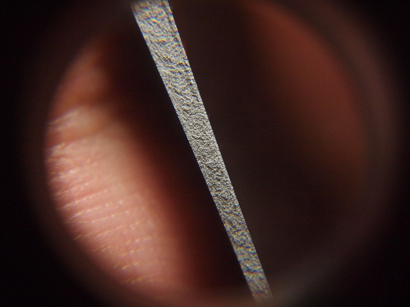

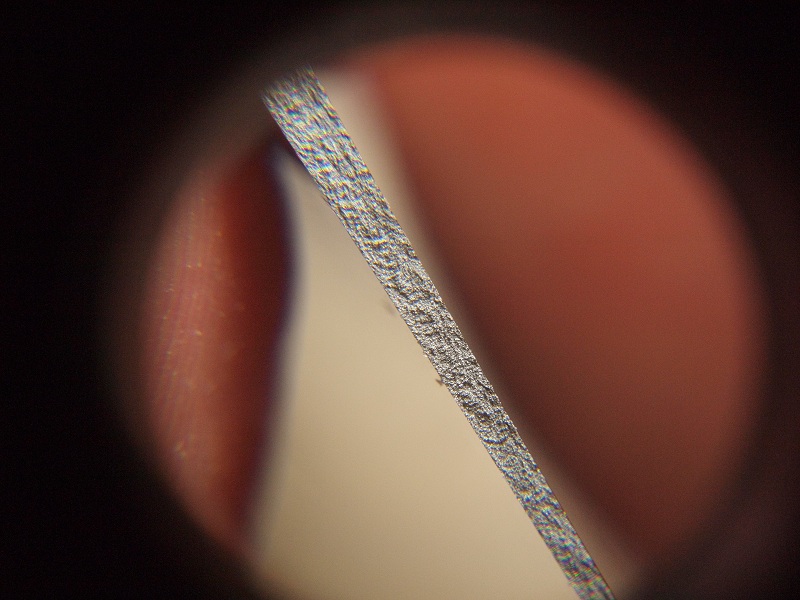

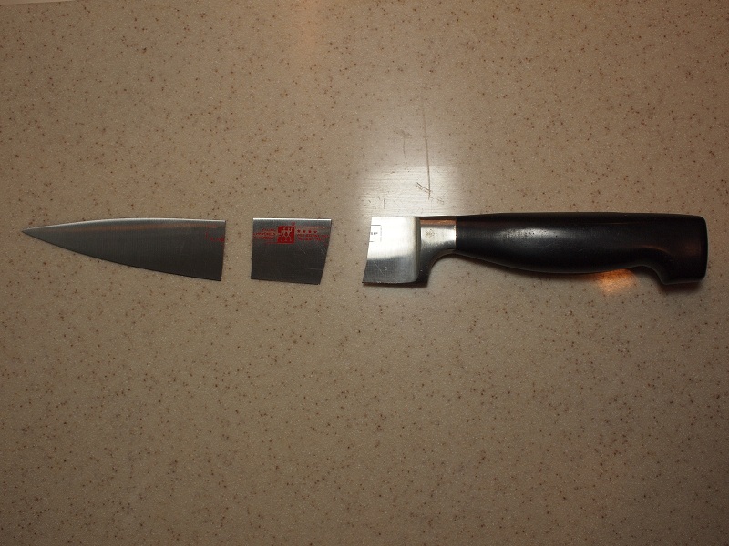

So I was straightening a friend's J.A. Henckel's utility knife to get it ready for sharpening. It's one of the Solingen-made Twins line, not the lower quality, Brazil-made International line. I've sharpened J.A. Henckels knives for this friend before, and I've had to straighten some of them, too. A little table-edge straightening fixed them all... until this one. I wasn't even putting a lot of weight into it and had just started when *SNAP*. This happened. I took macros of the steel cross section at the two break points. Do you guys see anything that might explain why this knife snapped like that?
have you tried to file that blade, those end shots are telling me its a very hard blade. Can you take one more picture that shows the whole blade.

Not sure what you mean by "file" the blade or "picture that shows the whole blade."
File the blade= just to feel if you can file it or not
The whole blade = I can't see the top or bottom edge of the blade in the pictures

overheated ? the grain looks way too big, thats a lemon imho.

you can see the grain and the break pattern, the fact that yours snapped straight without any deformation on the bent side means a lot to me. but, as always icould be wrong, its not my job.

Hi knifenut :) Not very bent, a slight bend but noticeable. I've straightened a lot of knives using the Mark Richmond method on a table, sometimes bending toward the table, but always lightly and incrementally, and my table has rounded edges, over which I place a towel. Never had a break before. I wasn't flexing it much at all. I had just tested it lightly at first and then started to apply a little pressure and *SNAP*. Some of the guys in the knife maker sub-forum think the grain is on the large side, which *might* be the culprit.

The fact that there are two breaks would indicate that hardness was the culprit, rather than a fault in the blade. I broke a M4 blade on an AFCK that I had a knifemaker reharden to 64 HRc. It also broke into three pieces and the grain structure looked similar.
If you can bend a blade to the point where it will hold a new position, you are going to fatigue that metal and leave it weaker. Probably not a big deal for a kitchen knife, but still an issue. It seems odd to me that your friend had so many knives that were bent. Maybe the QC on that batch of knives was lax.

The fact that it broke in two places at the same time leads me to believe that there were problems with the heat treat. Add that to the large grain size and it looks like a manufacturing defect.
The only time I ever got a break that looked like that was when I dropped a knife that had been hardened, but not yet tempered. Have you run a file across it to see how hard it is?
