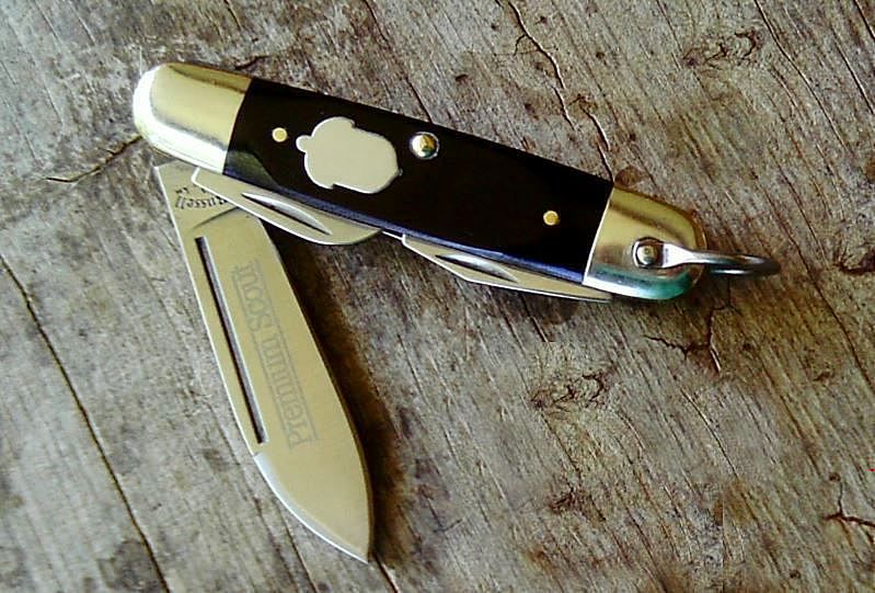

Want a SAK/Scout with high end steel? Get one of these....(top)
AG Russell Premium Scout in Micarta w/ a 154CM main.
