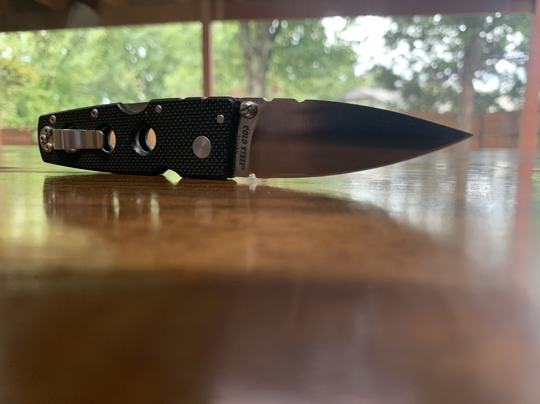

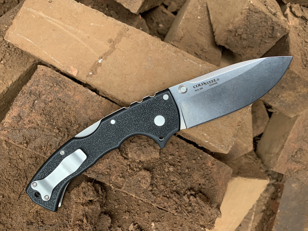

every what knife?Hello everyone! A while ago it was in trend for every knife to be thick ''atleast'' 3/16. I also got on that train, but then after using knives more and more, my knife choice and design has gotten slimer.
Thinner knives cut better and for me perform better too.
What do you say?
What works best for you and what are your prefrences? If you like them thicker, why and what advantages do they give for you?
Let me know!
Have a good day!
