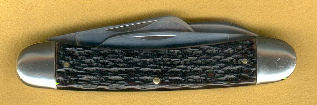

This picture was taken by LarryM for Ken Erickson,to show splitback whittler views,but it shows rounded bolster/round tang
And that,leads to.....some of those big whittlers,the main blades have the half stop,small blades don't

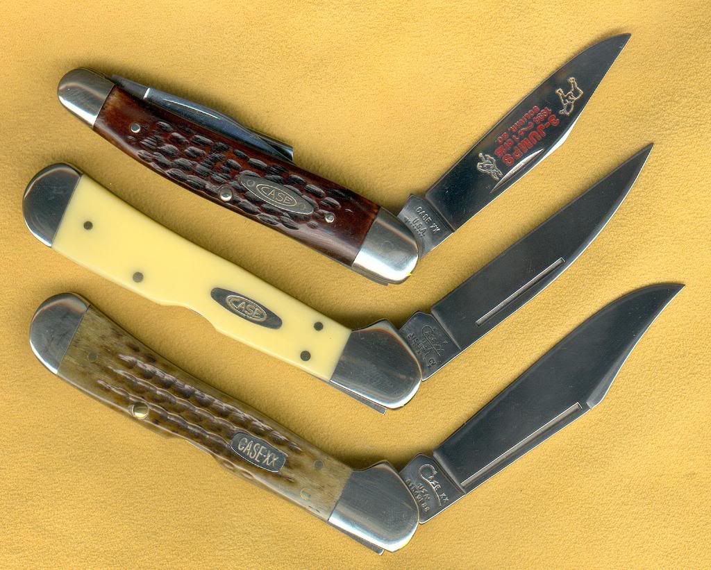

No half-stops anywhere on these; 2 copperlocks, and a 70s Case big whittler.

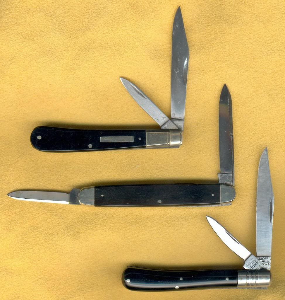

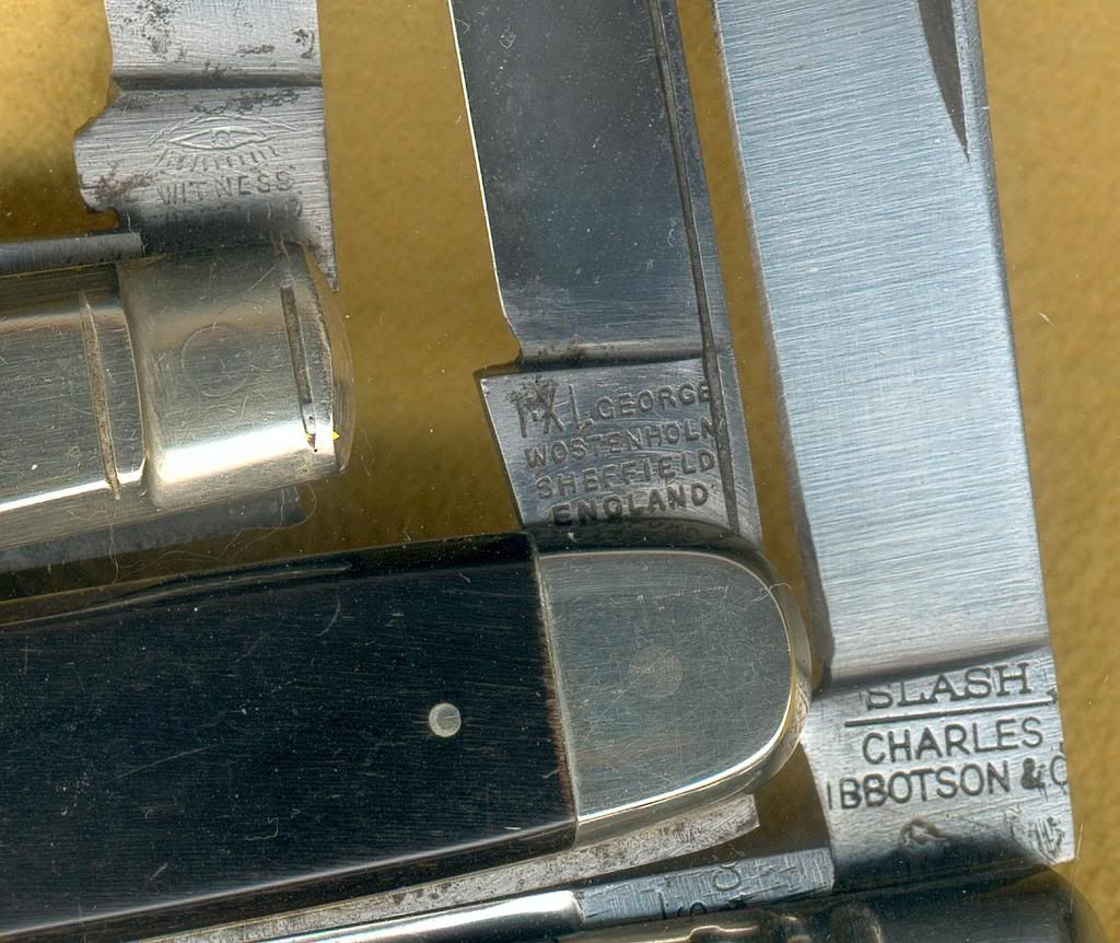

Interesting exception on your pen blade, Vince. I found one here, also. 3 Sheffield knives, all with round tangs, except the main blade on the multi-rat (we need the Pied Piper here) "Slash". The pen on that one is rounded.
Seems like we are proving here that MOST but not all knives follow the rule of square bolsters more likely to have half stops.
